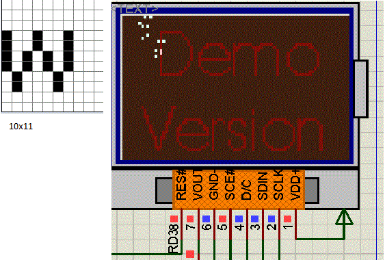

    My question is how can I display a font like the one below(please see attached image) this the hex equivalent...
    $08, $E0, $00, $E2, $01, $EE, $02, $62, $02, $06, $02, $0E, $03, $FC, $01, $F0, $01, $00, $00, $00, $00, $00, $00, $00, $00, $00, $00, $00, $00, $00, $00, $00, $00 ; for letter m
    Hope anyone can give me a hint on this.

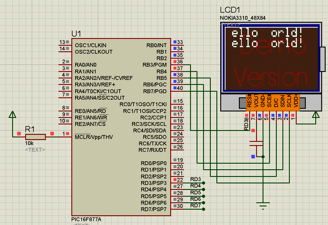

    I'm still stuck with this simple code I modified from Steve's NokiaGlcd examples..
    	DEFINE GLCD_CHAR_IN_EEPROM			   ' store/read character/lookuptable to/from EEPROM
    		DEFINE GLCD_STRING_IN_EEPROM		   ' store/read string to/from EEPROM
    		DEFINE GLCD_USE_SPECIFIC_CHARACTER	   ' We will define our own set of character to be used
            INCLUDE "..\Include\GLCD_NOKIA.PBP"    ' Plug the Nokia Driver/Wrapper in here
    		CHARTABLESTART
    				ADDCUSTOMCHAR CHR_CUSTOM_0, 0x04, 0x00, 0x00, 0x00, 0x00, 0x00, 0x00
    				ADDCHAR 'e'
    				ADDCHAR 'l'
    				ADDCHAR 'o'
    				ADDCHAR 'w'
    				ADDCHAR 'r'
    				ADDCHAR 'd'
    				ADDCHAR '!'
    		CHARTABLEEND
            '------------------------------< Main program >---------------------------------------------
            GLCD_CLS     ; Clear the screen (if not initialized yet, it will do automatically)
            GLCDOUT_AT?STR 0,0,"Hello World!"   ; Show String on Line 0
            GLCDOUT_AT?STR 0,1,"Wello World!"   ; Show String on Line 1
            GLCDOUT_AT?STR 0,2,"j"   ; Show String on Line 2
    Here:
    GOTO Here   ' sit & spin
    as I understood characters not defined within CHARTABLESTART and CHARTABLEEND will not be displayed...but I'm still having trouble displaying this character (j) 0x04, 0x00, 0x00, 0x00, 0x00, 0x00, 0x00
    any idea what I'm missing?
    regards,
    tacbanon
    Default Re: Display graphical font using Nokia3310LCD
    read again the readme.txt file example ...
    you have 2 extra argument in ADDCUSTOMCHAR, here you should have
    not
