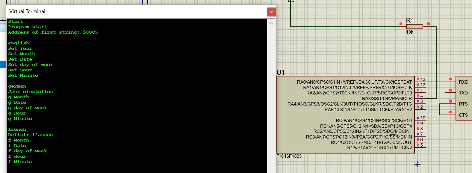

    and it is , i "fancied up" my code a bit and can change language with one var
    Name:  Screenshot 2021-12-31 210708.jpg
    mikes suggestion would be useful to allow a common set of string messages to read into hef in chosen language from a
    pg-flash coded larger multi-lingual data set.
    its all doable
