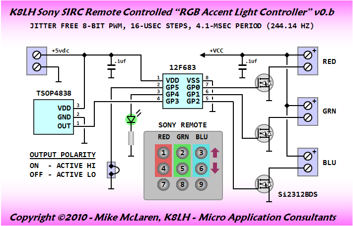

    May I ask how many RGB LEDs you're using? I've done Sony SIRC control of a single RGB LED with 6-bit (64 step) gamma corrected brightness levels spanning 8-bit (256 step) soft' PWM levels, but I used small tight isochronous assembly code.
