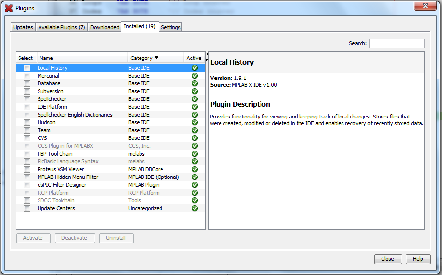

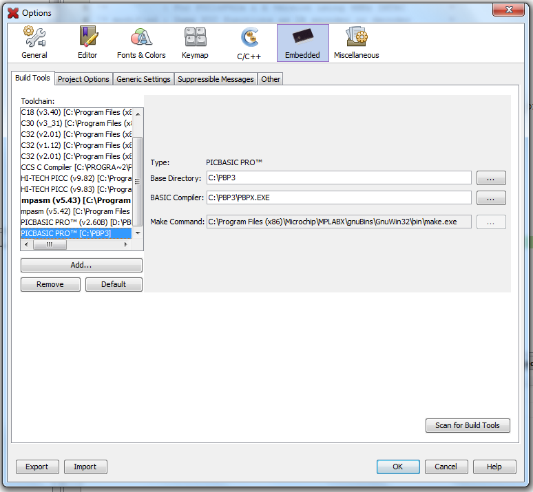

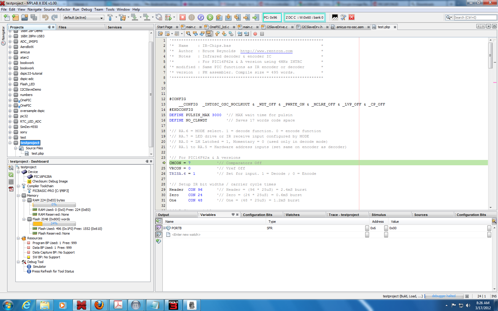

    Here are some pictures of the settings I currently have, and a screen shot of code stepping PBP3 in MPLABX.

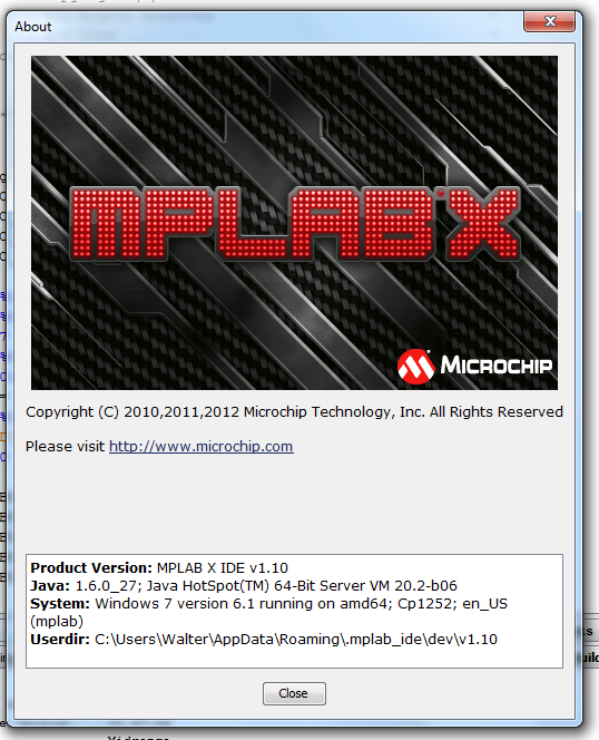

    I am now wondering if your errors could be a Java problem, with incorrect version. What do you get when you click on help, and info?
    Here is mine:

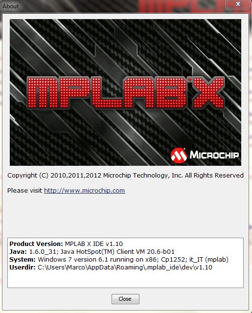

    My java version results 1.6.0_31 that seems newer than yours.

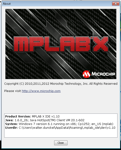

    Very interesting. Thanks Charles for looking in to it, and trying to update the plugin for the next MPLAB X release!
    It worked on both Windows 7 professional 32 bit, and Windows 7 professional 64 bit here.
    On the 32 bit, my info seems to be the same as Marcick's execpt for I have
    Java 1.6.0_26, and he has 1.6.0_31
    java hotspot 20.1-b02 , and he has 20.6-b01:
    I may try updating my Java and see if it breaks my setup, or try a fresh install on a different computer. Will let you know what I find.

    http://pbp3.com/downloads/com-melabs-pbptoolchain.zip
    Let me know what you find.
    I tested with a PICkit3. Source-level debugging works and it will show PBP variables in the watch window.
    MPLABX still seems a bit spotty for debugging. I'm hoping for some improvement in version 1.20.
    Thank you, Charles
    No errors with new plugin.
    Fabio
