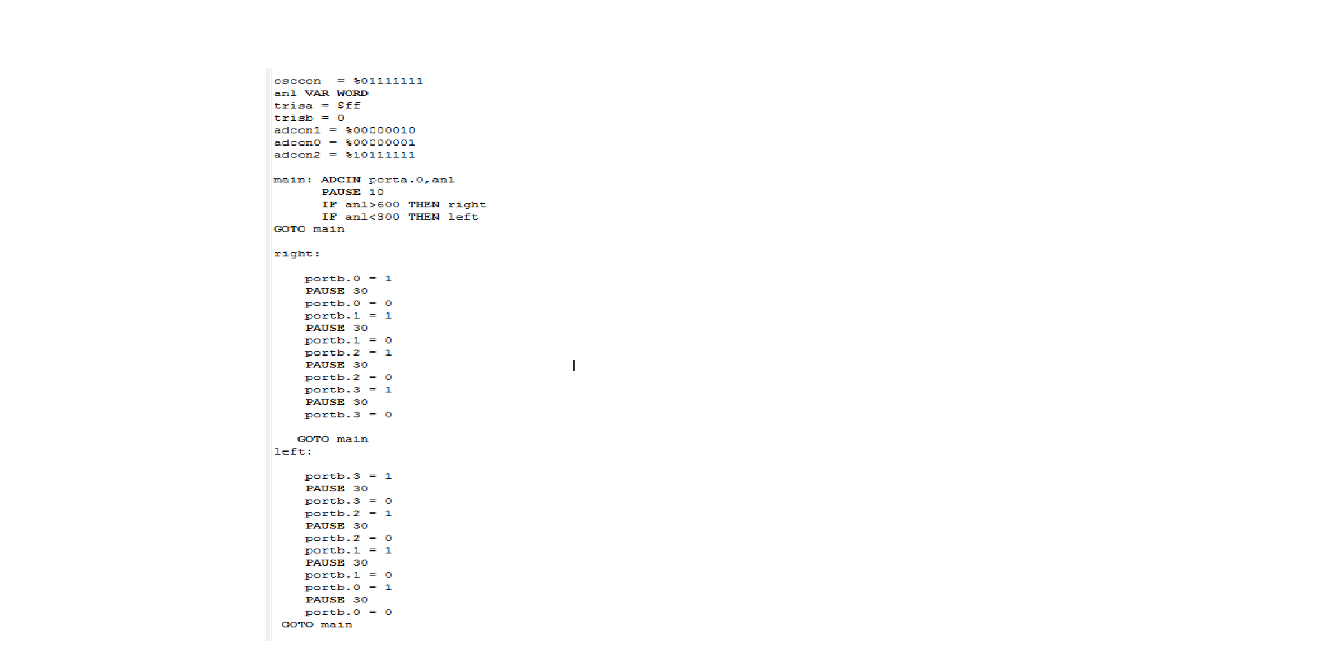

    I just wrote a simple program to check the operation of Analog to digital converter on my PIC18F4550, but the output is just meaningless. I have shown the program below, which is a simple program to control a stepper motor.
    I am not getting readings of (0 to 1023) on my lcd. Instead the value oscillates between ( 16 and 28 ) and most of the time unpredictable values.
    Plz help me out of this, I am stuck with this for 3 days...

    The first thing that pops out at me is the ADCIN line. The ADCIN command accepts the ADC channel, not the pin. Try this instead:
    ADCIN 0,an1

    Oh yes! you are right.. I will check it out tonight.
