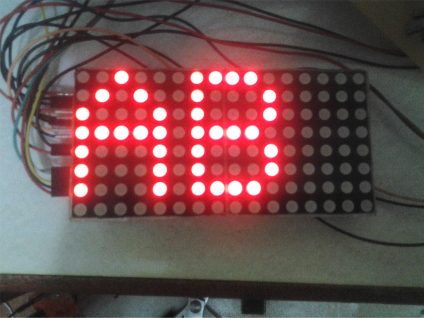

    I'm trying to modify font style for the led matrix display(2x 8x8) please image below.

    As I understood there are hex values for each letter to turn on the individual leds in columns. Is it possible to change the style like bold and italic and is there a tool that will make this task easier? Sorry to ask this too but is it possible to display animated icon like pac-man? I appreciate any help.
    Thanks in advance,

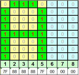

    The excel file attached lets you create fonts in dot matrix, and outputs the binary code for each column. Here is a description: http://www.instructables.com/id/LED-...cs-Generator-/
