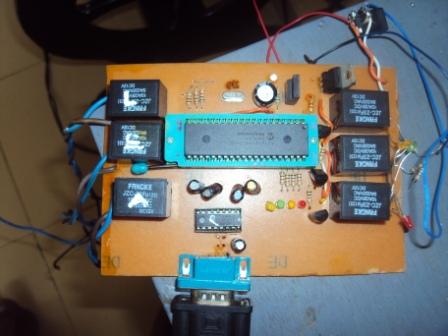

    my sms project
    3 input and 3 out put

    Hero000's Avatar
    Hero000 Guest
    Default Re: gsm modem with 16f877a
    Quote Originally Posted by kumara View Post
    my sms project
    Attachment 6608
    kumara"" I'm highly interested about it, please tell me about its working formula, efficiency etc.
