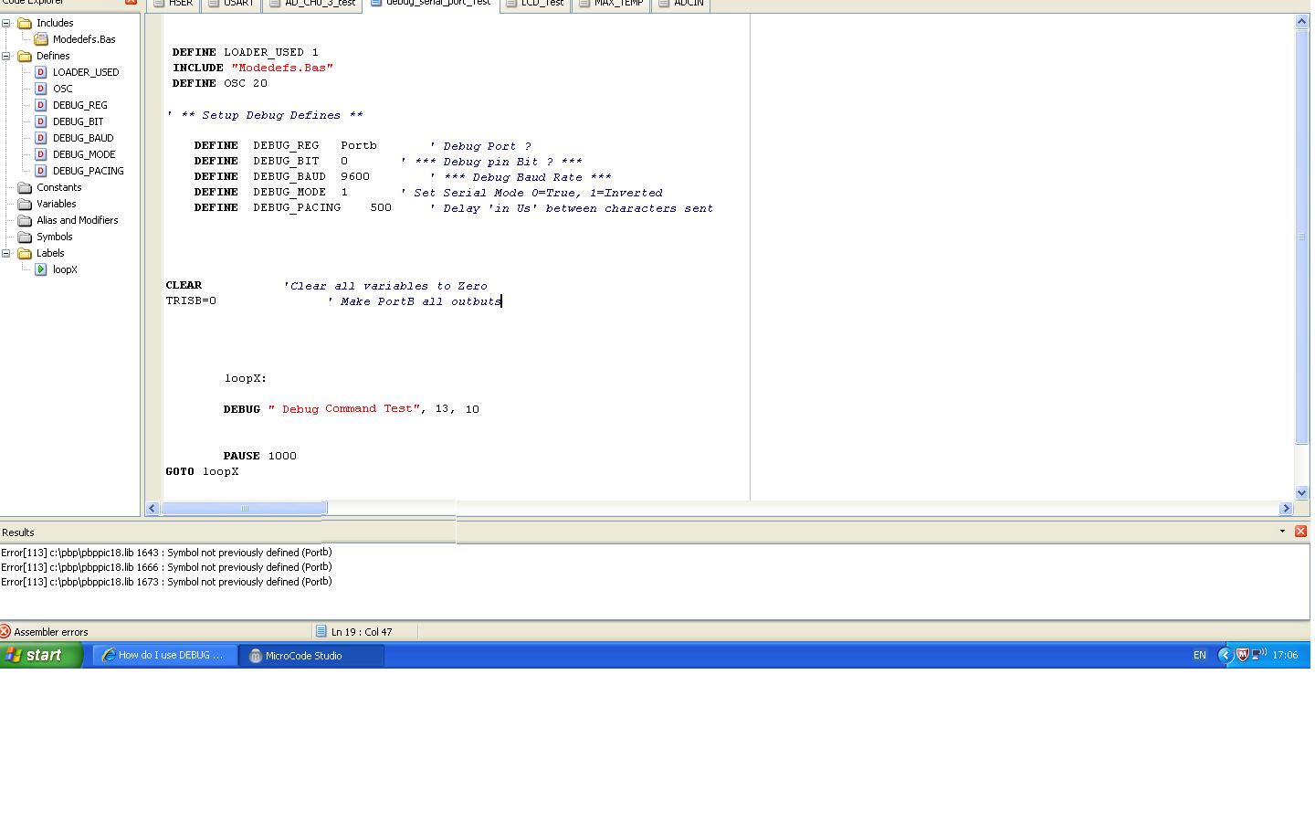

    Hello All
    i am just trying to use the Debug command for the first time as i alway use the Hserout but
    i need to save those pins for something else so i decided to use the Debug command on Port B.0
    but when i try to compile my program i get the following errors
    Default Re: Help with Debug Command
    MPASM is case sensitive.
    Use uppercase in your defines.

    Thanks DT
    much appreciated
