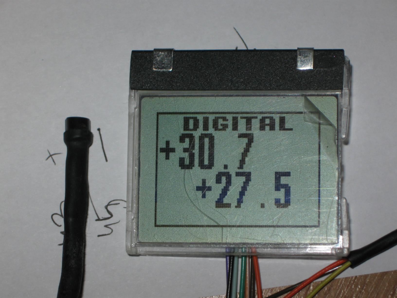

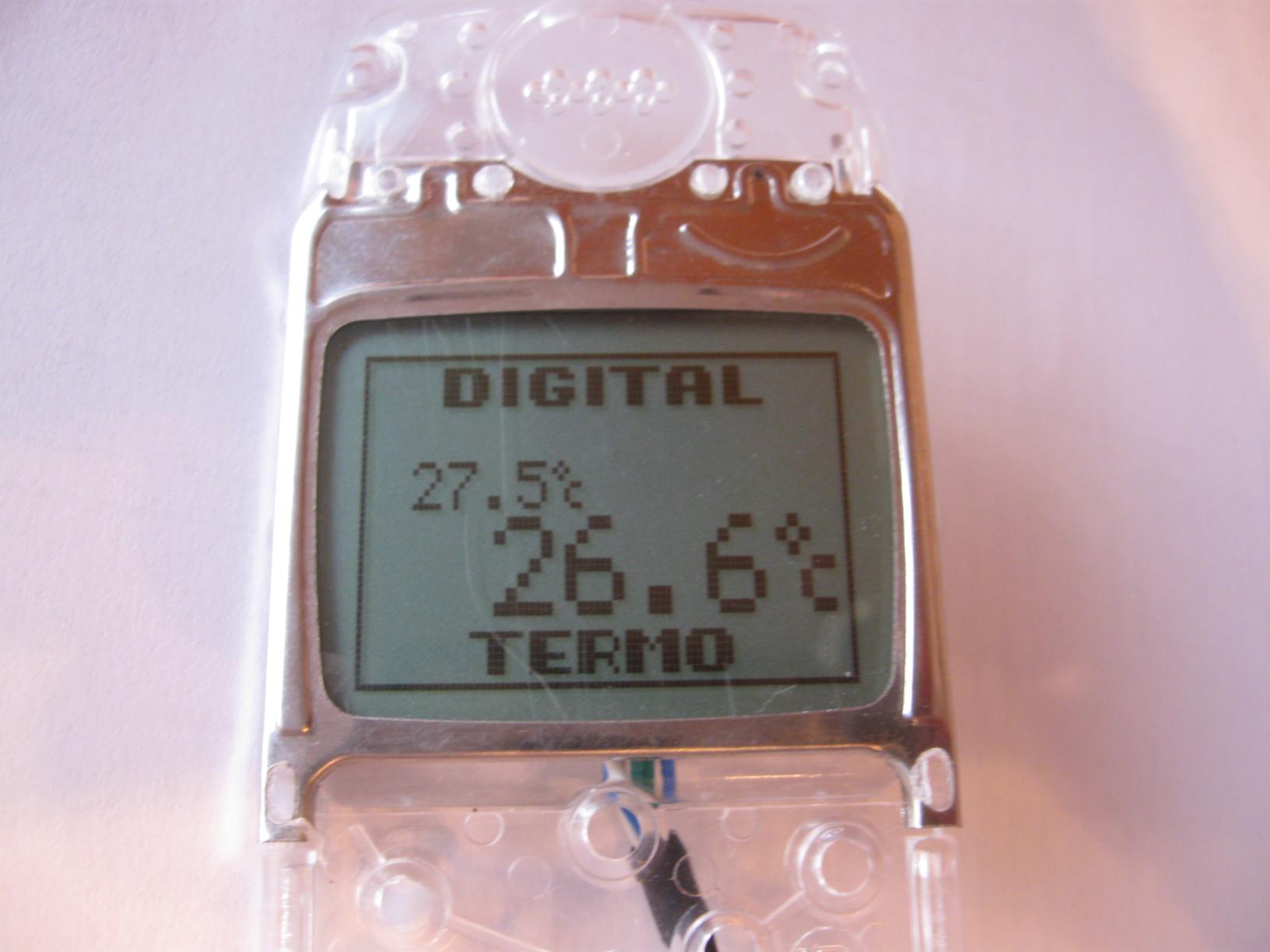

    I wrote the code for thermometer with two sensors DS18B20 and Nokia 3310 display. Works fine, but...only in 16F648A. I want to use with 16F628A (easier to buy in my location). It' s possible to "minimize" the code ? I think maybe can make something with 'BorderLine:" ...
    Thanks in advance !

    I did it !!!
    BorderLine:                         '
    '=================================== RAND 0
                     for y = 0 to 83
                     call setcursor
                     read y, LcdReg
                     call    PrintDataLcd
                     next y
    setcursor:
                    LcdReg  =  %10000000 + y           ' cursor  X
                   call    PrintCtrlLcd
                    LcdReg  =  %01000000            ' cursor  Y
                   call    PrintCtrlLcd
    ...and this is the result !
    Dec 2008
    Ploiesti, ROMANIA
    582
    Default Re: Need more space, please...
    The button alternate the two temperatures (small and big). Full working code ! Thanks for support ! Regards !
    Thanks !
    It's PIC 16F628A ("downgrade" from 16F648A - the reason of this topic) ; display it's from Nokia 3310. Regards !

    Now I have only dig 1 on display ....
    Dec 2008
    Ploiesti, ROMANIA
    582
    I have good results !
    Dec 2008
    Ploiesti, ROMANIA
    582
    Default Me, again...
    Hope not disturb !
    This is my last variant of dual thermometer.
    Last edited by fratello; - 1st June 2011 at 19:30. Reason: ...maybe someone want the code...

    Default Re: Me, again...
    Thank You so much for support !
    ...another fonts...

    I attach the code from termometer with two differents fonts : small and big. Enjoy !
