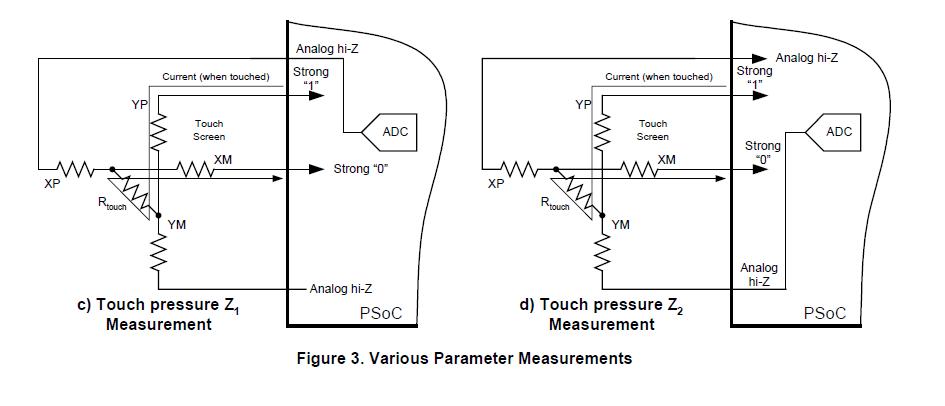

    Before you start reading the touchscreen coordinates, you need to know if the screen has been touched. By having 5V at Y+ and 0V at X- you monitor if the screen was touched. The setup is as follows

        LCDOUT $FE,$C0,"P1=",DEC4 PRESSURE_XP,", P2=",DEC4 PRESSURE_YM
        GOTO START
    If the screen is not touched then the reading for PRESSURE_XP is going to be very close to zero and the reading for PRESSURE_YM is going to be very close to 1024, remember it is a 10-bit ADC. The screen has been touched when the following condition has been met
        IF (PRESSURE_XP > 24) AND (PRESSURE_YM < 1000) THEN         ' THE TOUCHSCREEN HAVE BEEN TOUCHED

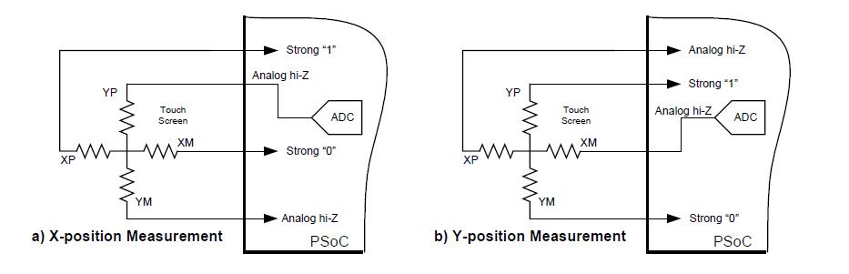

    To read the X,Y coordinates you need the following setup.
    And the code is
    '*         READ X AND Y VALUES SUBROUTINE                       *
    READ_COORDINATES:
        ' PORTA.0 (AN0) -> X+
        ' PORTA.1 (AN1) -> X-
        ' PORTA.2 (AN2) -> Y+
        ' PORTA.3 (AN3) -> Y-
        '################ READ AVERAGE X-VALUE ################
        TRISA = %00000011                   ' Set X+ (portA.0, AN0) and X- (portA.1, AN1) as inputs
                                            ' and Y+ (portA.2, AN2) and Y- (portA.3, AN3) as outputs
        low PORTA.3                         ' Set Y- = 0V
        high PORTA.2                        ' Set Y+ = 5V
        ADCON0 = %00000001                  ' Bits(5-2): 0000=AN0. Start sampling at X+
        pauseus 10
        ADCON0.1 = 1                        ' Stops or continues sampling depending on ADCON2 bits(5-3),
                                            ' then begins conversion
        GOSUB CONVERSION_ROUTINE            ' Obtain value for A/D conversion resolution
        X_VALUE = RESOLUTION                ' Obtain X_VALUE from X+ sampling, Y- = 0V, and Y+ = 5V
        ADCON0 = %00000101                  ' Bits(5-2): 0001=AN1. Start sampling at X-
        pauseus 10
        X_VALUE = (X_VALUE + RESOLUTION)      ' Obtain X_VALUE from X- sampling, Y- = 0V, and Y+ = 5V
        '################ READ AVERAGE Y-VALUE ################
        TRISA = %00001100                   ' Set X+ (portA.0, AN0) and X- (portA.1, AN1) as outputs
                                            ' and Y+ (portA.2, AN2) and Y- (portA.3, AN3) as inputs
        low PORTA.1                         ' Set X- = 0V
        high PORTA.0                        ' Set X+ = 5V
        ADCON0 = %00001001                  ' Bits(5-2): 0010=AN2. Start sampling at Y+
        pauseus 10
        Y_VALUE = RESOLUTION                ' Obtain Y_VALUE from Y+ sampling, X- = 0V, and X+ = 5V
        ADCON0 = %00001101                  ' Bits(5-2): 0011=AN3. Start sampling at Y-
        pauseus 10
        Y_VALUE = (Y_VALUE + RESOLUTION)      ' Obtain Y_VALUE from Y- sampling, X- = 0V, and X+ = 5V
    '*         CONVERSION SUBROUTINE                                *
    CONVERSION_ROUTINE:
        REPEAT          ' Wait until conversion is finished. When finished ADCON0.1 will be =0
            PAUSEUS 10
            CONV_STATUS = ADCON0.1
        UNTIL CONV_STATUS = 0
        RESOLUTION.BYTE0 = ADRESL : RESOLUTION.BYTE1 = ADRESH       ' READ A/D CONVERSION VALUE
    For the final routine "CONVERT_TO_PIXELS" the constants Ax, Bx, Ay, and By should be found experimentally. They will vary depending on the resolution of the LCD screen. One thing to remember is that the relation of the 4-wire touchscreen readings and the corresponding LCD pixels behaves almost linearly.
    '*         CONVERT_TO_PIXELS ROUTINE                            *
    CONVERT_TO_PIXELS:
         'Ax, Bx, Ay, and By should be found experimentally
        X_VALUE = Ax * X_VALUE + Bx
        Y_VALUE = Ay * Y_VALUE + By
