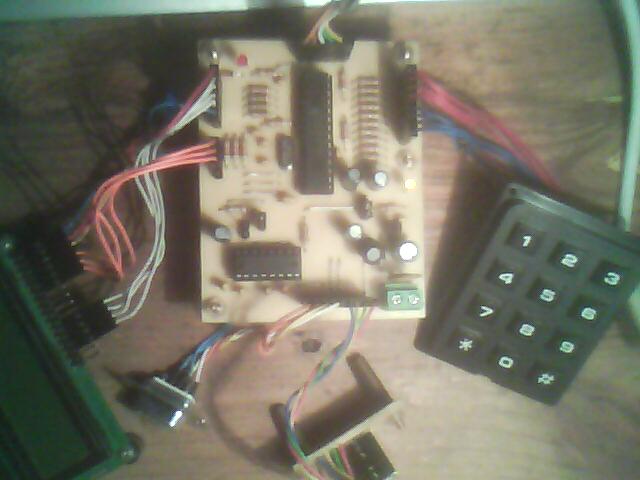

    I have to made strange looking “usb” keyboard with big buttons, that will interact with “On Key what ever” event on regular PC. I will switch IP Cameras.
    So in tree beers time I draw some hardware (attached below). I call this “kitchen made” prototype, because I will make him there. Well, I can buy numeric pad and put her in my grande buttons box (GBB) but this will not make me happy. It will be nice to choose char code for keys or even a string.
    So I need help. After 2 hours googleing I have no answer on this – how to tell to PC, that this is standard keyboard?
    I extend my board with LCD, RS232 and ICSP capability just in case. If someone find my board useful and if this someone lives in Europe, I can send him a board.

    I started the thread, so I feel duty to finish. Down is the hardware ready to go.
    There is a little error in the circuit. The diode D1 is in wrong direction.

    There is some code. The keyboard is ok, but the usb out freezes the pic.
    Also windows don’t recognize the board as keyboard. I try to use
    #define use_usb_bus_sense_io
    from kbddesc1.asm, but I got undefined variable error in USB18 here:
    957: # ifdef use_usb_bus_sense_io
    958 btfss usb_bus_sense
    959 bra somewhere
    What to do?

    Well, there is missing USBInit in the code.
    This is happen when my beer is over.
    Now Windows say: "There is unknown usb device"
    What must to be changed in the descriptor?

    By the way the board is still not recognized by Windows as HID. I check report descriptor twice,
    the device descriptor seems ok but pic freezing by usbout.
    May be some configs are wrong? I dont have any.

    OK its done. The problem was in the serial bootloader.
    And for ICSP the reset cap C3 must be far below 100nF - 10nF or lower.
    I will post code soon as is ready. Then will make fun with the serial bootloader. I love UARTs!

    ANDDDDDDDDDDDD: The Grande Button Box (GBB)
    But I still have questions.
    1. Can I simple relocate code and interrupts with some ORG
    when I use serial bootloader?
    2. Is there some negotiation between PC and usb HID(KBD) like these
    with PC/2 keyboard -
    code?
    When I plug the box everything seems ok except that: the first pressed key is doing
    strange things – repetition of chars, TAB, Window switching or nothing. And this relays to elapsed time from plug to press?!.
    3. Is there “USB READY” call back or just a bit for such purpose?
