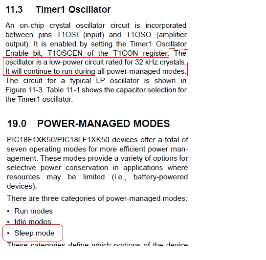

    This shuts down the selected oscillator and all clock source status bits are cleared.
    However the only peripheral that needs to run is the Timer1 to trigger the interrupt, but that can only happen if the secondary oscillator is running. If there's no way to use SLEEP mode while keeping the secondary oscillator running, then I should probably use the SEC_IDLE mode... hopefully the peripherals don't drain that much power.
    If you put a crystal on the Timer1 oscillator, enable T1OSCEN and change TMR1CS before going to sleep with an appropriate reload value for the lower frequency ... you could put it to sleep.

    Hmm I don't really understand, I have this at the beginning of my code during initialization:
    T1CON = %01101011 'Set Timer prescaler to /4 and enable Timer1 on external 32768Hz crystal
    T1OSCEN = 1 (secondary 32768Hz oscillator is enabled)
    TMR1CS = 1 (timer clock source is secondary 32768Hz oscillator)
    My setup already use the Timer1 for both interrupt and general clock source when in low power mode, and it does work as expected.
    I tried to add that T1CON configuration line above my @ SLEEP instruction but that didn't help much. If the SLEEP mode actually turn off all clocking sources then T1OSCEN bit should be set to 0 as well.
    Maybe using the IDLE mode and manually disable all peripherals that are enabled default would be a workaround.
    Timer1 oscillator continues to run during sleep mode, but ... try it like this.
    First, comment all the OSCCON and OSCTUNE statements you showed above.

    One of them disables the Primary Oscillator, which will keep it from running after it wakes up I would assume.
    Dec 2007
    Paris
    101
    Yes but I commented all others as well. I just quoted the lines that caused the interrupt to stop working.
    I want to disable the primary oscillator, because I have 2 operating modes:
    1) USB attached, clocked from a 12Mhz ceramic resonator, with PLL enabled and CPU clocked at 48Mhz
    2) USB detached, standalone, CPU and peripherial clocked from Timer1 secondary oscillator.
    When the CPU wakes from sleep it should resume on the oscillator defined by the SCS bits, here SEC_RUN mode:
    OSCCON.1 = 0
    OSCCON.0 = 1 'Use Timer1 oscillator as clock source
    Now you found that statement back from the datasheet, there's hope to make it work! I'll investigate harder and make some tests on a simplified program.
