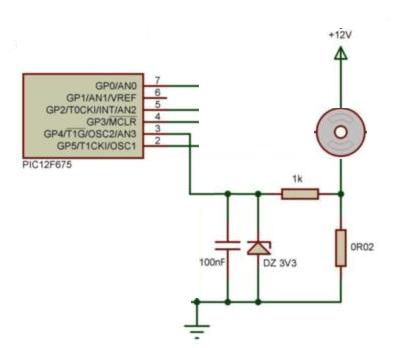

    Nice subject !
    I use a similar code for reading the over-current of one DC motor :
    check:
     vt  =0
     vs  =0
     grup=0
     cnt =0
     pause 50
     for cnt = 1 to 10
     	adcin 3, adval
     	vt=adval * 5000
     	vt=div32 1023
     	grup=vt+grup
     	pause 5
     next cnt
     vs=grup / 10
          if (vs > checkin) or (T1Count > 50) then
      	     	gpio.0=0
               	gpio.5=0
    If the averge of 10 readings it's bigger than checkin value (or time exceed 5 seconds) then gpio.0 and gpio.5 goes low.
    It's one good ideea to use ADCON instead ADCIN ? How to do this and keeping average of 10 readings ?

    Default Need advice, please !
    It's this correct ?
    In header of code I add :
        ADCON0 = %10001101      ' ADC input on GPIO.4/AN3/pin3 (page 41)
                                ' MSB 1 = Right Justify                   "1"
                                '     0 = Vdd as voltage reference        "0"
                                '     0 = n/a                             "00"
                                '     0 = n/a
                                '     1 = select channel 03 (bit 2 of 2)  "11"
                                '     1 = select channel 03 (bit 1 of 2)
                                '     0 = conversion status (see routine) "0"
                                ' LSB 1 = A/D converter module is on      "1"
    And I modify the "check" subroutine like that :
    check:
     vt  =0
     vs  =0
     grup=0
     cnt =0
     pause 50
     for cnt = 1 to 10
          ADCON0.1 = 1
          NOT_DONE:
    		if ADCON0.1 = 1 THEN NOT_DONE
                Pause 10
                adval.highbyte = ADRESH
                adval.lowbyte = ADRESL
     PAUSE 10
     	vt=adval * 5000
     	vt=div32 1023
     	grup=vt+grup
     PAUSE 10
     next cnt
     vs=grup / 10
      	     	gpio.0=0
               	gpio.5=0
    The hardware it's in picture.
    Thanks !
    Dec 2008
    Ploiesti, ROMANIA
    582
    Default Re: Stable ADC readings
    I've tested the code ; it's OK.
