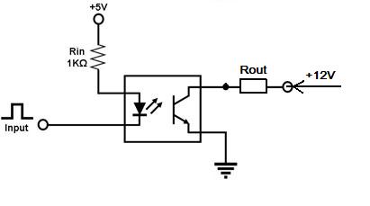

    Aug 2011
    40
    Default Re: 16F877A system and tachometer (FIS version) on the table
    My program works like this :
    a detection for RBx cause a different display to FIS Tachometer and for input isolator (output RC5,6,7) cause a +5V and +12V on output isolator .
    BUT it is dangerous because a +12V on output isolator cause a failure on FIS tacho input voltage .
    I would like only a No intrusive +12V but GROUND ONLY (action with ground input RBx) .
    May 2008
    Italy
    825
    If your FIS tacho device doesn,t requires too much current at the inputs the opto is the solution ( remember that the signal is inverted. in other words when pic pin is low the output is high) I have separated the two grounds, but they can be common.
    If on the other hand you will require more current at the input then use the second solution which uses two transistors.
    Cheers
