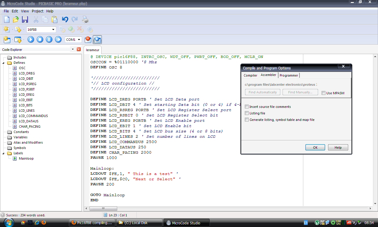

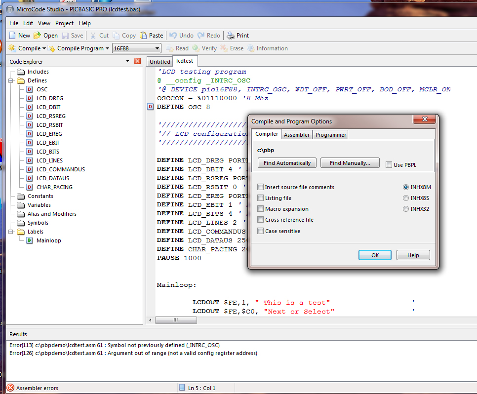

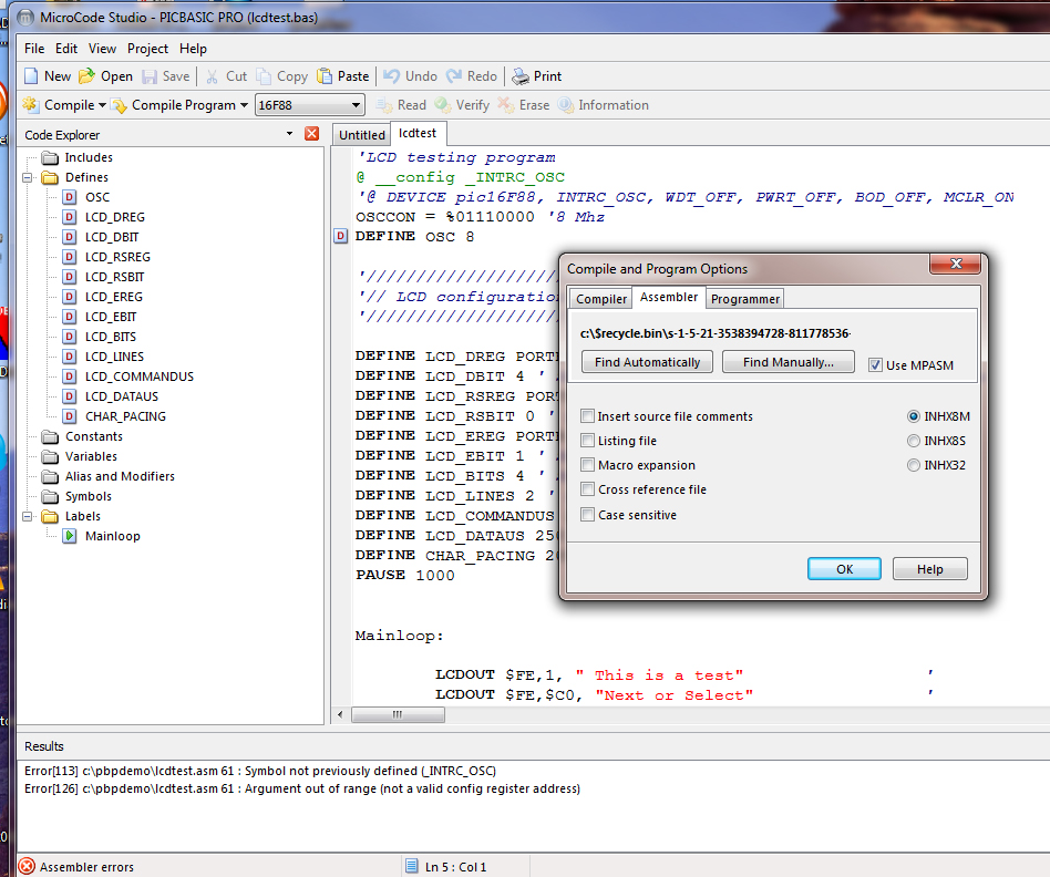

    Here is the configuration I have:
Size:  440.1 KBName:  mcs2.jpg

    Did you notice that it selected the assembler from your recycle bin?
    Also, it has been several years since I worked with the 16f88, but iirc it has at least one of the peripherals enabled by default. You must go through each and every pin used with the lcd and make sure it is configured to be a regular i/o pin, and not configured as a peripheral pin.
    Sep 2006
    747
    Default Re: Pic16f88 compiling. . not working
    Yes I saw it refers to the recycling bin. although it does not find it automatically. and I do not know what to choose. The help file in the micro code studio is not very helpful in that regard.
    MPASM should be C:\Program Files\Microchip\mpasm suite
    or something like that.
