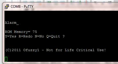

    Needed more space and the eeprom was not being used after $10.
    So here are two version of using the eeprom space. [256 bytes -- use a byte for indexing]

    #1 is easy to see what the text is, but wastes a byte for the end of text marker.
    ' EEPROM Storage done at compilation time
    '==========  ends with a ZERO ====== Wastes a byte ==========
    W_Enter  Data        "Enter",0
    W_YNRQ   Data        "Y=Yes R=Redo N=No Q=Quit ?",0
    W_Want_to  Data     "Want to",0
    Main
    ' Call the print progam that uses zero as the end of text marker.
    zb= W_YNRQ : GOSUB Print_ROM_0
    '== SUBROUTINE =============================================================
    Print_ROM_0:   ' Call with zb = ROM_Memory_Location [byte]
    ab = 0
      debug "ROM Memory= ", #zb , CR,LF   ' normal debug output command
      Do
        read zb, ab
        if !ab then debug ab
       zb= zb + 1
      loop until !ab   ' SAME AS AB = 0
    #2 is mostly easy to see what the text until the last char. The last char has $80 [128] added to it.
    This does not waste a byte for the end of text marker.
    CharBump        con $80
    ' @$10 ==> starts the data at eeprom location $10
    '==========  ends with the last character >128 - Does not Waste a byte ========
    Ofuzzy1 data @$10,   "(C)2011 Ofuzzy1 - Not for Life Critical Use", "!" + CharBump
    W_Alarm  Data        "Alarm", "_" + CharBump
    W_Min    Data        "Mi", "n" + CharBump
    Main
    ' Call the print progam that uses last byte over 128 as the end of text marker.
     zb= W_Alarm : gosub Print_ROM_127
    Print_ROM_127:   ' Call with zb = ROM_Memory_Location [byte]
    bb = 1
      Do until !BB ' SAME AS  "Do until BB = 0"  but uses one less byte
        read zb, ab
        if ab > CharBump-1 then    ' > 127
            ab = ab - CharBump
            bb = 0
        debug ab  ' Debug like all the other printing commands does not allow any math operations
        zb= zb + 1
      loop

    data @00,                       word    0                ' clear the burner's blanking
    data @T_Min_Default_LOC,        word    20
    '                   012345678901234567890123456789
    '                   01234567890ABCDEF0123456789
    '   *** Mark the end of the words with Char + 128
    CharBump        con $80
    ' @$10 starts the data at eeprom location $10
    gosub CR_LF        ' call the print a linefeed and a carriage return
    DEBUG CR, LF, Vtab ' directly output via serial:
    '                     CR LF & VTAB [clear screen - works on some terminal programs]
    gosub CR_LF : gosub CR_LF
    gosub Print_Copyright ' example as call for multiple use printing
    End  ' All good things need to come to an end.
    '======= The subroutines ==============================================================
    CR_LF:
    debug CR,LF
    Print_SP:
    debug " "
    ' uses last byte over 128 as the end of text marker.
    Print_Copyright:
    gosub Print_SP : gosub Print_SP : gosub CR_LF ': gosub CR_LF
    zb= Ofuzzy1 : gosub Print_ROM_127
    bb = 1
        read zb, ab
            ab = ab - CharBump
            bb = 0
        zb= zb + 1
      loop
    ab = 0
      Do
        read zb, ab
       if !ab then debug ab   ' same as ab <> 0 then ...
       zb= zb + 1

    Here's a slightly better version for #2
    Print_ROM_127:   ' Call with zb = INTERNAL ROM_Memory_Location [byte]
      Do until AB > 128
        READ ZB, AB     BB = AB & $7F ' drop the upper bit, DEBUG does not allow any math functions during output.
        DEBUG BB     ' Debug like all the other printing commands does not allow any math operations
        ZB= ZB + 1   ' Increment through the string
      Loop
