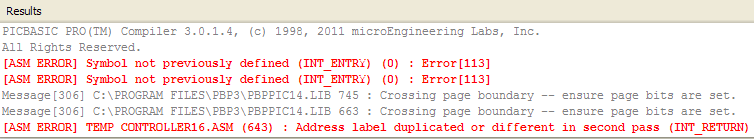

    Well, now that I've switched from PBP2..6 to PBP3 I seem to be having trouble with DT_Interrupts in some "previously working" code.
    I've read the manual about migrating from PBP2.6 to 3.0, and have successfully applied it to other programs, but can't seem to get it going on this one.
    The chip is a 16F726. It uses DT_interrupts in a touch sensor routine.
    The code worked when compiled with PBP2.6 but creates some "ASM Errors" with PBP3
    Here's the errors I get:

    Default Re: My DT_Interrupts broke in PBP3... guess I'm too dense too figure out why
    DT_INTS in not part of the device configuration.
    Don't put #CONFIG/#ENDCONFIG around them. Put it back to ASM/ENDASM.
    And watch the indentation. ASM is sensitive to that.
