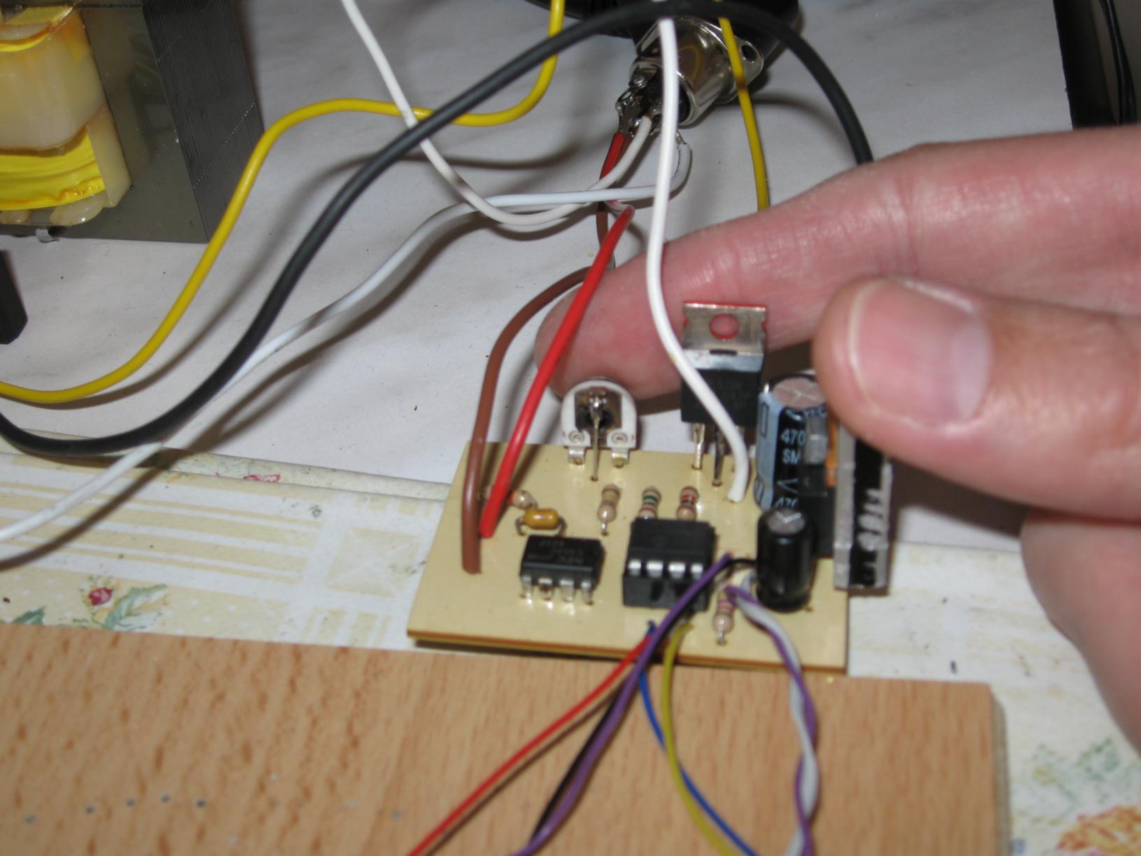

    Using Pensol SL10, one cheap 12F675 and N3310 display, I made for myself this soldering station. Works fine, the mos-fet remains cool, but... I wonder if my code it's the better way to drive the mos-fet and keep most accurate temperature of iron ("pwm mosfet, 255, 300").
    Any advice it's wellcome ! Thanks in advance !

    Default Re: Soldering station
    Thanks to all for support !!! Glad to see people helping others...
    I will take attention to inc_PID, but ... now my code is 1002 words . The best (so far) solution it's to "upgrade" the PIC (maybe 18F...) but, for moment, I will try to keep this "low-cost variant".
    You can still shave some bytes...
    - you don't need 2 spi routines LCD_ByteOut & PrintDataLcd,
    - replace the For-To-Next loop with Repeat-Until ones,
    - if at all possible, try to skip the div32.
    - use internal timer for delays (not sure it will that much though
    - pwm with a high/low loop maybe?
    - select case for a couple a if-then
    couples of ideas like that. sounds like a nice challenge
    Wow ! Great support here ! Thanks to all !!!
    In first post You can see : the temperature it's in Celsius degrees. The PID control it's a verry good ideea; sure I will use in future projects !
    But...I try to do like Mr. Ioannis :
    if w1 < (calibra - 5) then pwm mosfet 255, 300
    if w1 < (calibra - 3) then pwm mosfet 155, 250
    if w1 < (calibra - 1) then pwm mosfet 100, 200
    I think to reduce the "power" of heating by adjusting the pwm factors... It's OK ?!
    I wrote this :
    but the heating start ONLY when w1 < (calibra - 3) !
    Why don't start when w1 < (calibra - 1) ?!?
    4,170
    And what is the value of w1 then?
    Dec 2008
    Ploiesti, ROMANIA
    582
    Example : if calibra (value for memory, set by user) is 140, the heating start at 137.
