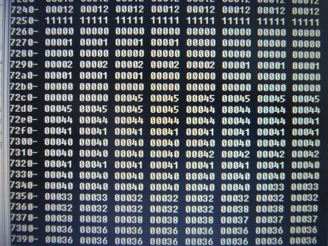

    There is 13 blocks of 256 words that make up the map data and when I view the pic memory I can see areas with rows of zeros and some 00001 and 00002 where a value of 55 should be. this fail area is for 4 memory rows and then comes good. When upload of map is in progress the stepper driver is set to disable and .12 amp of draw only from power supply in this state so noise at this time is unlikely.
    see picture taken from meProg The row with 11111 is a partition only and npt read. Below that the values should be progressively larger than the 45 values that are correct.
    Beginning to suspect the usb to serial adapter. This is difficult to see because if the data string is not AxxxxBxxxx then error occures. so the error is only in the values after B as the correct addresses are written . It is as if the charge pump runs out in the pic and then recovers. Also the defective area is mainly in a similar area. Tricky hey
