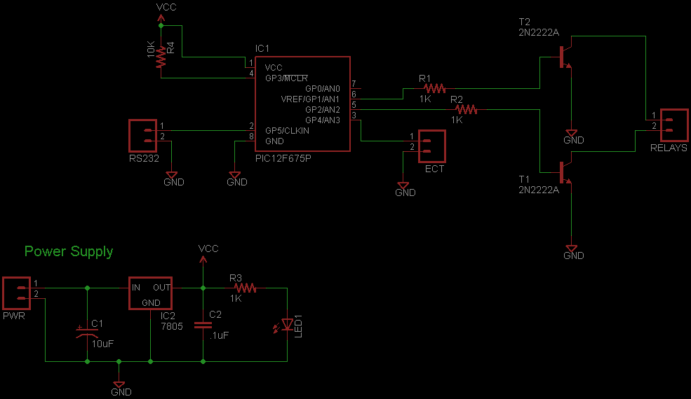

    What I was wanting to know, is there a better way of reading the voltage using an ADC on the 16F675. Here is my code, and I also attached a picture of the schematic. The SEROUT portions will eventually be removed once develpment was complete. They were just used so I could test the circuit while at the car. The fan-relays on the car also have flyback-protection diodes.

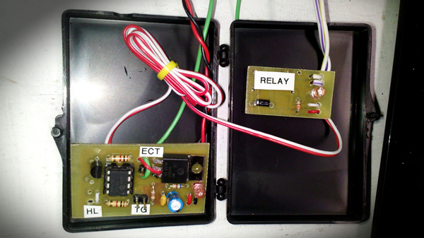

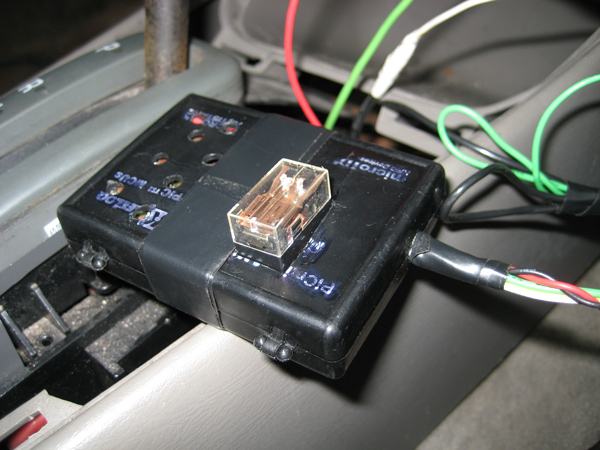

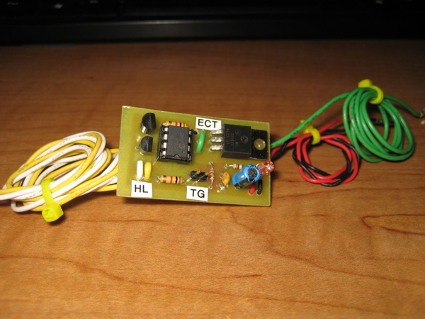

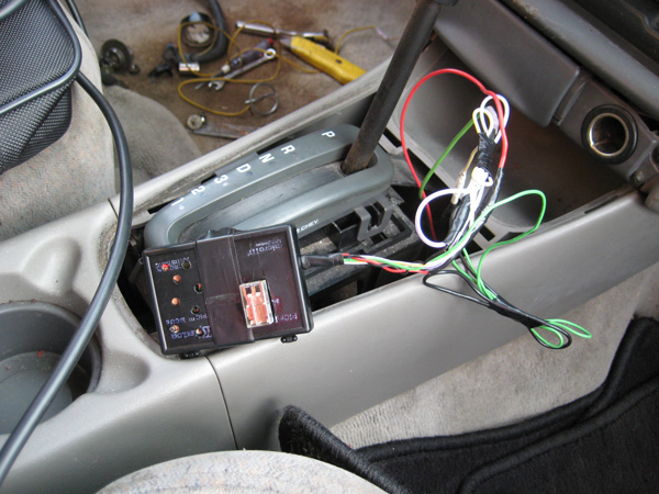

    After a few weeks of work and family things, I finally found the time to complete the project. The ACDIN results were inconsistent at first, but I etched a new board and instead of SMD components I used thru-hole. The new board worked perfect on the bench but failed on the car...until I realized I had used a NPN transistor instead of an PNP. Before I realized this I made a small relay board that the transistor would switch, which would then turn on the cooling fans. I salvaged the relay from an old TRS-80 motherboard that was ruined. Once the transistor was swapped out and the relay board added, everything worked perfect. We took some test runs, and the cooling fans turned on/off as expected. When the transistors were switched I also had to reverse the high/low settings on the relay outputs on my board. My personal blog has a little more info. http://triton9.wordpress.com/
    Thanks again to everyone for all the help!!

    I specialy like the custom MicroChip enclosure.....
    EN82fn
    Jun 2011
    St. Louis, MO
    13
    Default Re: ADCIN giving inconsistent results
    Yeah...cant beat free!! I have a few of those sitting around gathering dust so it seemed like a perfect reason to get rid of one. First we cut a small rectangle in the top for the relay, then my friend drilled some holes for airflow.
