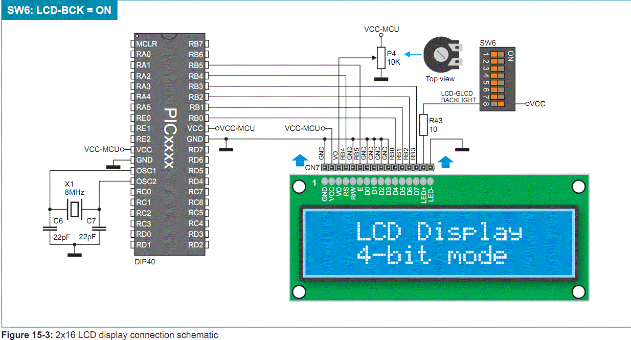

    Hi, sorry to post this beginner question, but I'm having trouble displaying text to the LCD with Pic18F4550 on 4Mz..
    Define OSC 48      ' Core is running at 48MHz
    Define LCD_DREG  PORTB
    Define LCD_DBIT  4
    Define LCD_RSREG PORTB
    Define LCD_RSBIT 4
    Define LCD_EREG  PORTB
    Define LCD_EBIT  4
    DEFINE LCD_LINES 2 		' Set number of lines on LCD
    DEFINE LCD_COMMANDUS 2500
    DEFINE LCD_DATAUS 250
       ADCON1 = 15          ' Set PORTA and PORTE to digital
       Pause 100            ' Wait for LCD to start up
    mainloop:
       Lcdout $fe, 1        ' Clear screen
       Pause 500            ' Wait .5 second
       Lcdout "Hello"       ' Display "Hello"
       Lcdout $fe, $c0, "World" ' Move to line 2  and display "World"
       Goto mainloop            ' Do it forever
    Attached is my pin connections on easypic6Name:  lcd+Con.gif
    I'm having doubts with my LCD Settings, and how can I make it work using 8Mz crystal?
    thanks in advance,
    tacbanon
    Default Re: Help on lCD and PIC18F4550 setup
    I think this should be portb.5
    Define LCD_DBIT  4
    Define LCD_RSBIT 4
    Define LCD_EBIT  4
    And if you are using a 4 or 8 mhz crystal, then you probably are not running at 48mhz.
    Define LCD_DBIT  0
    Define LCD_RSBIT 4
    Define LCD_EBIT  5

    Thanks for the responce mister_e and scalerobotics. I tried your suggestions but still have no text display on the LCD...
    I make sure that in the configuration setting Oscillator is HS..any idea what I'm doing wrong?
    tacbanon,
    Not sure why you want to run at 48 MHz clock rate, but here is a routine that I have used at 8 MHz on a 18F4550 (and I know it works) on my EasyPic6 with PBP v2.6.
    '*  Name    : EasyPic_18F4550_DisplayDemo.pbp                  *
    '*  Author  : John R. Ellis                                     *
    '*  Date    : 11/28/2009                                        *
    '*  Notes   : Setup is for use on EasyPic6 development board    *
    '*  Device  : 18F4550 installed in EasyPic6                     *
    '*  Memory  : 408 bytes of Program Memory required              *
    '*  Ref:    :                                                   *
    Define OSC 8
    ;--- if you un-comment these, you must comment the ones in the .inc file--
    ASM ; 18F2550/4550, 8mhz crystal
       __CONFIG    _CONFIG1L, _PLLDIV_2_1L & _CPUDIV_OSC1_PLL2_1L & _USBDIV_2_1L
       __CONFIG    _CONFIG1H, _FOSC_HSPLL_HS_1H
       __CONFIG    _CONFIG2L, _PWRT_ON_2L & _BOR_OFF_2L & _VREGEN_ON_2L
       __CONFIG    _CONFIG3H, _PBADEN_OFF_3H ; PortB resets as digital
       __CONFIG    _CONFIG4L, _LVP_OFF_4L & _XINST_OFF_4L
    INCLUDE "ALLDIGITAL.pbp"    ' Sets all registers for digital ops.
                                ' User must make sure the AllDigital.pbp file
                                ' is in same directory location as this source
                                ' code before compiling.
        'DEFINE SHOWDIGITAL 1     ' When uncommented will show analog settings
                                ' in Assembler Results window.
        ' A/D & Comparators disabled for digital ops
            ' All of these statements should be commented out when using the
            ' INCLUDE "AllDigital.pbp" statement to set digital ops.
                'ADCON1 = %00001111
                'CMCON = 7
    ' Initialize Hardware
        TRISA =%00000000
        TRISB =%00000000
        TRISC =%00000000
        TRISD =%00000000
        TRISE.0 = 0
        TRISE.1 = 0
        TRISE.2 = 0
        INTCON2.7 = 0
        '** DEFINE LCD Control Constants **
        L       CON 254           ' Control Byte ($FE)
        Clr     CON 1             ' Clear the display
        Line1   CON 128           ' Point to beginning of line 1 ($80)
        Line2   CON 192           ' Point to beginning of line 2 ($C0)
    ' LCD DEFINES FOR USE WIH 2x16 LCD INSTALLED IN EASYPIC6
        DEFINE LCD_DREG PORTB       ' Use PortB for LCD Data
        DEFINE LCD_DBIT 0           ' Use lower(4) 4 bits of PortB
                                    ' PORTB.0 thru PORTB.3 connects to
                                    ' LCD DB4 thru LCD DB-7 respectively
        DEFINE LCD_RSREG PORTB      ' PORTB for RegisterSelect (RS) bit
        DEFINE LCD_RSBIT 4          ' PORTB.4 pin for LCD's RS line
        DEFINE LCD_EREG PORTB       ' PORTB for Enable (E) bit
        DEFINE LCD_EBIT 5           ' PORTB.5 pin for LCD's E line
        DEFINE LCD_BITS 4           ' Using 4-bit bus
        DEFINE LCD_LINES 2          ' Using 2 line Display
        DEFINE LCD_COMMANDUS 2000   ' Command Delay (uS)
        DEFINE LCD_DATAUS 200       ' Data Delay (uS)
    'Main Loop
        Pause 1000                          ' Delay to let LCD start up
        LCDOut L,CLR:Pause 50               ' Clear Display
        LCDOut L,Line1+2," TEST "           ' Display "TEST" on 1st line
        PAUSE 500
        LCDOut L,Line2+2,"..Power On.. !!"  ' Display "Power on" on 2nd line
        PAUSE 10000
        Goto Main                           ' Continue loop

    I always put these reminder comments in my code when attempting to program to my EASYPIC6. Are you sure you have the switch settings correct on your EASYPIC6 according to these instructions?
    ' * NOTES for use with EasyPic6 development board:
    'For use with COG 2x16 LCD:
    ' - Turn on Port Expander switches SW6.1, SW6.2, SW6.3, SW6.4 and SW6.5.
    ' - Turn on COG LCD 2x16 switches SW10.1, SW10.2, SW10.3, SW10.4, SW10.5
    ' and SW10.6.

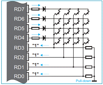

    Hi, I'm trying to run this example code using the Matrix keypad routine from Mister_e
    INCLUDE "KeyPad.bas"    asm
        __CONFIG    _CONFIG1L, _PLLDIV_5_1L & _CPUDIV_OSC1_PLL2_1L & _USBDIV_2_1L
        __CONFIG    _CONFIG2L, _PWRT_ON_2L & _BOR_ON_2L  & _BORV_2_2L  & _VREGEN_ON_2L
        __CONFIG    _CONFIG2H, _WDT_OFF_2H
        __CONFIG    _CONFIG3H, _MCLRE_ON_3H & _LPT1OSC_OFF_3H & _PBADEN_OFF_3H & _CCP2MX_ON_3H
        __CONFIG    _CONFIG4L, _STVREN_ON_4L & _LVP_OFF_4L & _ICPRT_OFF_4L  & _XINST_OFF_4L & _DEBUG_OFF_4L
        endasm
    DEFINE    OSC 48
    DEFINE LCD_DBIT 0
    DEFINE LCD_EBIT 5
    DEFINE LCD_RSBIT 4
    DEFINE LCD_BITS 4
    DEFINE LCD_LINES 2
    DEFINE LCD_DATAUS 50
        '    Hardware connection
        DEFINE KEYPAD_ROW        4       ' 8 row
        define KEYPAD_ROW_PORT   PORTD   '   on PORTB
        DEFINE KEYPAD_ROW_BIT    4       '
        DEFINE KEYPAD_COL        4       ' 4 col
        DEFINE KEYPAD_COL_PORT   PORTD   '   on PORTA
        DEFINE KEYPAD_COL_BIT    0       '
        DEFINE KEYPAD_DEBOUNCEMS 200     ' debounce delay = 200 mSec
        define KEYPAD_AUTOREPEAT 1       ' use auto-repeat
        '    Serial Communication definition
        'DEFINE HSER_TXSTA 24h            ' enable transmit, BRGH=1
        'DEFINE HSER_SPBRG 129            ' 9600 Bauds
        '    Variables definition
        myvar                    var byte
        '    ---------------------------------[Program Start]----------------------------------------------
    start:
        @ READKEYPAD _myvar
        Lcdout $fe, 128,"Key=",dec myvar
        goto start
    But the program just freeze on my easypic6, initially displays "Key=20", I'm using PortD for my keypad(4x4) and I made sure I have pull down-PortD. I set DEFINE KEYPAD_COL_BIT 0 and DEFINE KEYPAD_ROW_BIT 4 (I also tried to inverse them 4-0) but the same problem. Can you tell me what I'm doing wrong on my setup?
    thanks,
    tacbanon
