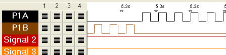

    Yup, I scoped them all and I have never a signal on P1B (PORTC.4)

    It works as expected here!
    Have you tested PORTC.4 to see if it's blown, or you have a problem with something connected to it?

    Well....
    .... a new PIC did the trick.
    Thanks a lot for your help.
    The biggest surprise is not that I'm a little bit stupid, it's more that I am a witness of a miracle: I understood (a part of) the datasheet by myself!!!!
