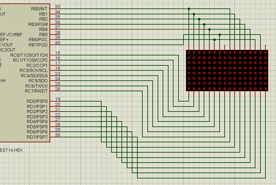

    Just connect RD7 to matrix and having 8 columns instead 7 . No software update required.Name:  update (Custom).jpg

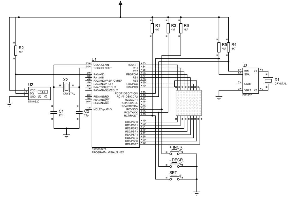

    what are the values of X1 and X2,?
    Dec 2008
    Ploiesti, ROMANIA
    582
    Default Re: Scrolling thermo
    X1=32768 KHz (see app note for DS1307) ; X2=4MHz (see second line of program file).
