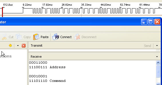

    Hi Guys
    Ok, I am totaly stumpped with this, I have tried to use a timer as suggested by dhouston & I have been trying the pulsin method as suggested by bogdan but I get the same problem, the start pulse is all over the place, it ranges from 0 to 255 etc, it seems random.

    There are much better/faster ways to do this, but this should get you started with something that's fairly easy to understand.
    Assuming you have an NEC transmitter that outputs something like the top portion of the graphic below;
    This should return similar results to what's shown in the serial terminal window just above.

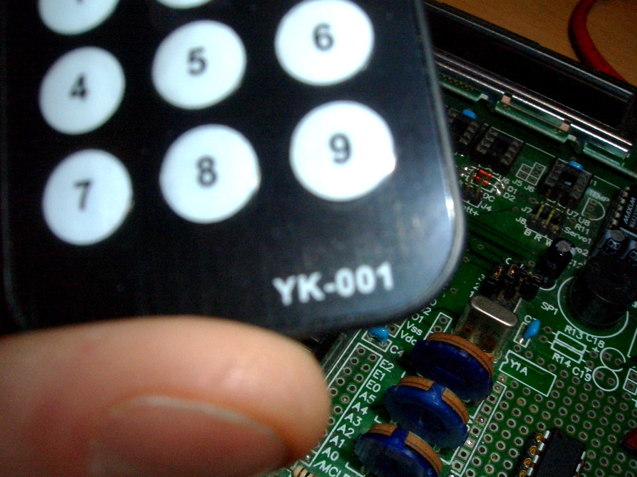

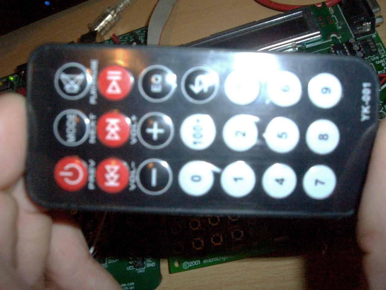

    Bruce, thanks for uploading that code, I am going to try the code on my next day off work and will report back, I've had a look and its well commented and I can understand it, so I have fingers crossed that it's going to work :-), I think where I am falling down is my poor understanding of math, eg the osc speed and its relation to ms's & pulsin, I just dont get that, anyway I'm going to give your code a good go, thanks again.
    Bogdan, I have attached my remote pictures & instruction PDF that came with it, thanks also for your help with this :-)
