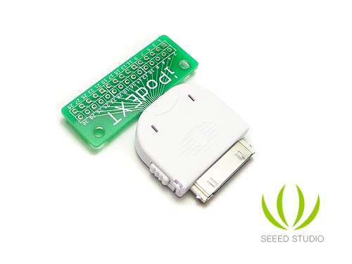

    I will like to play with the iPod Accessory Serial Protocol too.
    Do you recomend this for start ?
    http://www.seeedstudio.com/depot/ipo...pod-p-148.html

    Hi Bogdan,
    Great starting point, I'll order one as well!
    Have butchered a PCB from one of the many cheap junk radios with a Ipod dock. The pins and pitch of the connector make it challenging to work with and could also be the reason for m problems.
    Longer term have ordered a couple of IPOD 17 wire extension cables, I'll cut the female connector off and wire the fly lead to my pcb.
    Keep us posted on this thread, I'll do the same.
    Rob.
