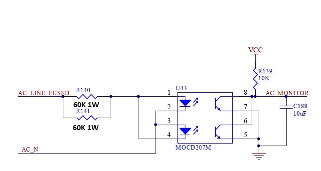

    But if you simply want to monitor the AC line, then you don't really need interrupts. I'll attach a circuit that (I think) does what you want. The output is LOW whenever there is AC present. The capacitor keeps it from going high during zero-crossings.
    And - it has isolation.Name:  ACMonitor.jpg

    The circuit works for both 110V and 220V.

    I tend to replace R140 & R141 with a simple capacitor... Xc, seems to work really well.

    I'm in agreement that a .47uF cap works well, but you still have to have some sort of resistor in series (1K or so), otherwise really short risetimes will blow the LEDs. I use resistors here because they are smaller than a 400V cap.
