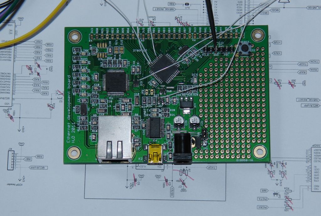

    It contains a PIC18LF46K22, the W5100 ethernet chip, place for SST25VF SPI flash memory and FTDI USART. I'll send you a blank board if you want.
    The W5100 handles all the heavy lifting and supports TCP/IP, UDP and RAW so I guess it should be handle whatever protocol EtherLAB/EtherCAT is actually using. Obviosuly the W5100 adds a bit ($5) to the cost and ups the hardware complexity of the project a bit compared to a single chip solution like the 87J60.
    The drawback with my board (for the application I envision you do doing) is that the W5100 talks to the PIC over SPI, this brings down the potential thru put of data but the W5100 supports bus interface as well but then it requires a boatload (25+) of I/O's from the PIC.
    The W5100 contains 8k of memory so if you're trying to do the realtime stuff on the PIC you can use that memory as a buffer - but that kind of defeats the purpose of the realtime EtherLAB engine....
    Anyway, I'll stop rambling now. But if you would care to elaborate a bit on what exactly is supposed to happen at the "PIC end" of the line perhaps we can come to a better conclusion on what might work and what won't.
