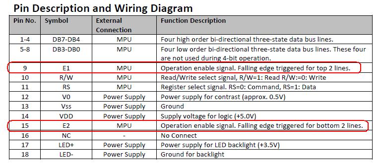

    I just got this 4x40 character NewHaven LCD display.
    http://www.newhavendisplay.com/specs...WH-ATMI-JT.pdf
    From the datasheet you can see that it has two enable pins, E1 and E2. E1 for the top two lines and E2 for the bottom two lines.
    Now, from the well known PBP procedure that we all use to drive these character LCD displays we only have access to one enable pin.
    DEFINE LCD_DREG PORTA 全et LCD Data port DEFINE LCD_DBIT 0 全et starting Data bit (0 or 4) if 4-bit bus DEFINE LCD_RSREG PORTA 全et LCD Register Select port DEFINE LCD_RSBIT 4 全et LCD Register Select bit DEFINE LCD_EREG PORTB 全et LCD Enable port DEFINE LCD_EBIT 3 全et LCD Enable bit DEFINE LCD_BITS 4 全et LCD bus size (4 or 8 bits) DEFINE LCD_LINES 2 全et number of lines on LCD
    Is there any workaround for this problem? How can I make this 4x40 display work?

    Thanks Steve. That will do it.
