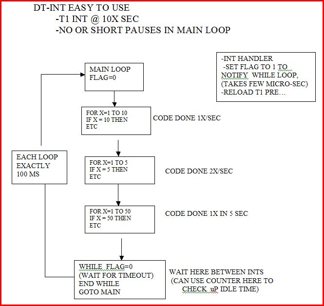

    Default Re: Not getting this timer thing.
    Consider dt-ints and this structure.Name:  INTERRUPT.JPG
