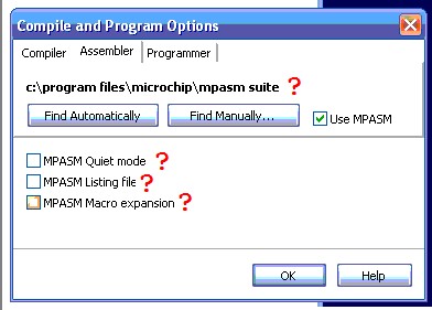

    I was going to give DT instant interrupts a test drive... but I see over on his web site that you MUST be using MPASM. I use Microcode Studio and when I went to change the assembler... It did not "Find Automatically", I tried to "Find Manually" but I can't get it to work... also there are several checkboxes that I am unsure of the best choice.

    To use MPASM you have to install MPLAB.
    Reason to use... for things like DT's interrupts and 18F chips.
    Works with MCS and FineLine.

    I did get MPASM working.
