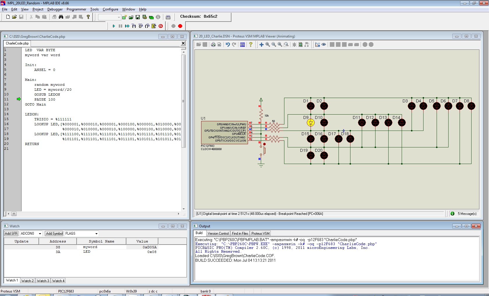

    I'm curious to know if ISIS allow to debug the source code with latest PBP and MPASM...
    Default Re: ??? can I
    Yes you can.
    You can use it stand alone to step through the source code.
    Or use it in MPLAB to single step and watch the variables.
    http://www.picbasic.co.uk/forum/atta...1&d=1309807487
    Last edited by Darrel Taylor; - 4th July 2011 at 20:29. Reason: Added ISIS/MPLAB image

    Thanks, I may have a 367,358,284,956th try some day. Couldn't be worst than before I guess.
