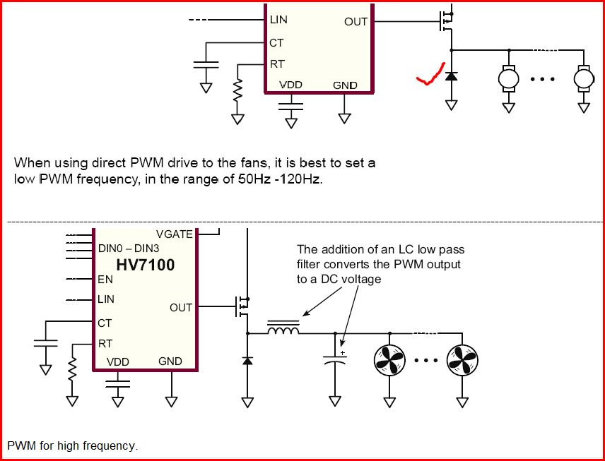

    Default Re: PWM fan speed control with a 12F683
    Using Sayzer's code, attached, I've been able to control an LED as desired.
    Coupling that to a larger current drawing device is a problem. Of the schematic page provided, the top drawing has pulses at GP2 to the MOSFET of about 2.3 volts and won't power on the fan. I thought once I figured out how to get the pulses up to around 5 volts the FET would turn on and I'd be golden.
    The lower schematic adds R1 and R2 so I get around 4.8 volt peaks with varying RMS values but even with the larger pulse size it still won't turn on the fan. I felt really stupid after I figured that one out.
    I can connect the gate to +5V and it will turn the FET on and drive the fan. Although I don't think it's bringing the fan up to full speed.
    So what in hell am I missing? Why won't the chip drive the FET to turn on the fan?
    Check PWM freq,
    If too high, the inductance of the motor affects operation, add diode across motor pointing up, returns energy to motor when MOS FET switches off. Hardware PWM freq only goes so low. May need INT to PWM or do it in basic.
    The ckt shows P-channel MOS but your N-channel setup is ok.
