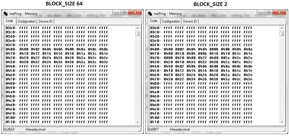

    By the way, before you replied, I tried a small program (with block size = 2) and it seemed to work for the first 64 bytes under a cycle of 256, not from the 65th to the end;

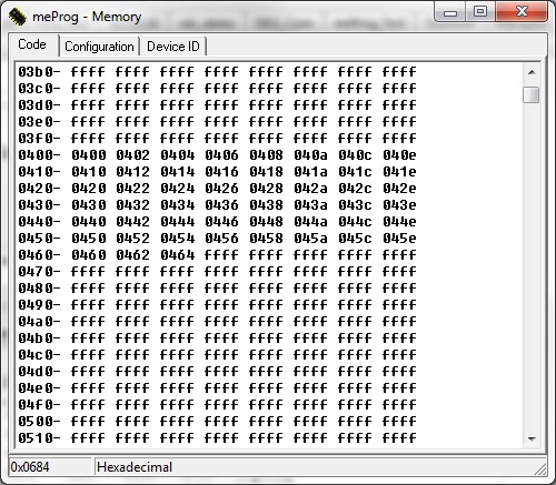

    So, the solution for my thread is definitely the assembly, however I'm posting the code and the result:
    CONTAW VAR WORD
    ERASECODE $3000                                    '1k from $3000 will be erased
    FOR CONTAW=0 TO 255 STEP 2                  'writes 256 bytes, 1 word for address
        WRITECODE $3000+CONTAW,CONTAW     'On each address, wrties a word containing the cycle index
    NEXT CONTAW
