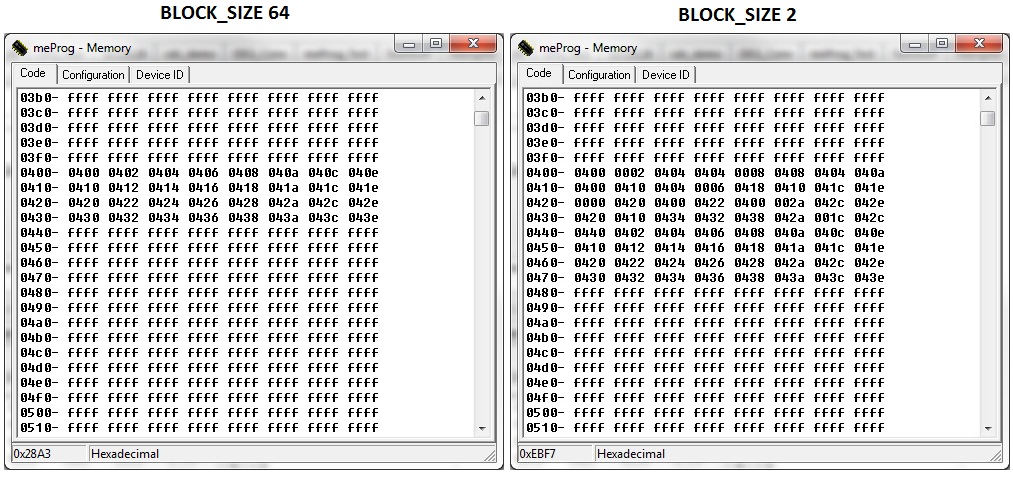

    For example, using the following code it tries to write 100 BYTEs to Flash. At each word location it writes the address of that word. The results were read back with a U2 programmer.
    The image on the left is with BLOCK_SIZE = 64. Only 64 out of the 100 BYTEs actually gets written. This is the normal operation of WRITECODE.
    The image on the right is with BLOCK_SIZE = 2.
    It was still writing 64 bytes at a time, but it was doing it for every 2 bytes.
    The holding registers don't get cleared, and the data gets really messed up.
    It ends up writing 128 bytes with BAD Data.

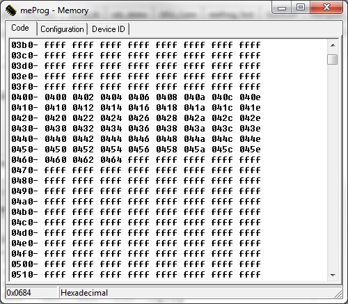

    You can see in this image that it writes the correct data.

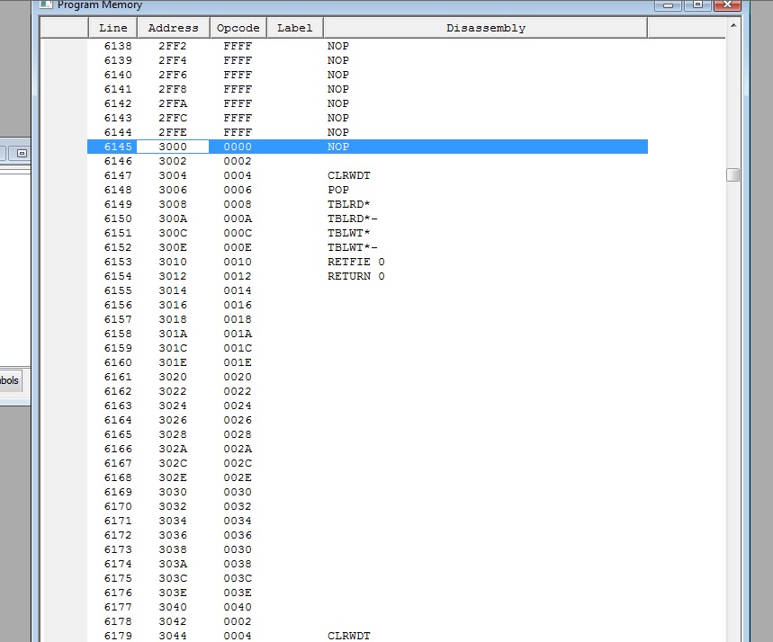

    By the way, before you replied, I tried a small program (with block size = 2) and it seemed to work for the first 64 bytes under a cycle of 256, not from the 65th to the end;
    So, the solution for my thread is definitely the assembly, however I'm posting the code and the result:
    CONTAW VAR WORD
    ERASECODE $3000                                    '1k from $3000 will be erased
    FOR CONTAW=0 TO 255 STEP 2                  'writes 256 bytes, 1 word for address
        WRITECODE $3000+CONTAW,CONTAW     'On each address, wrties a word containing the cycle index
    NEXT CONTAW
    Thank you again!
