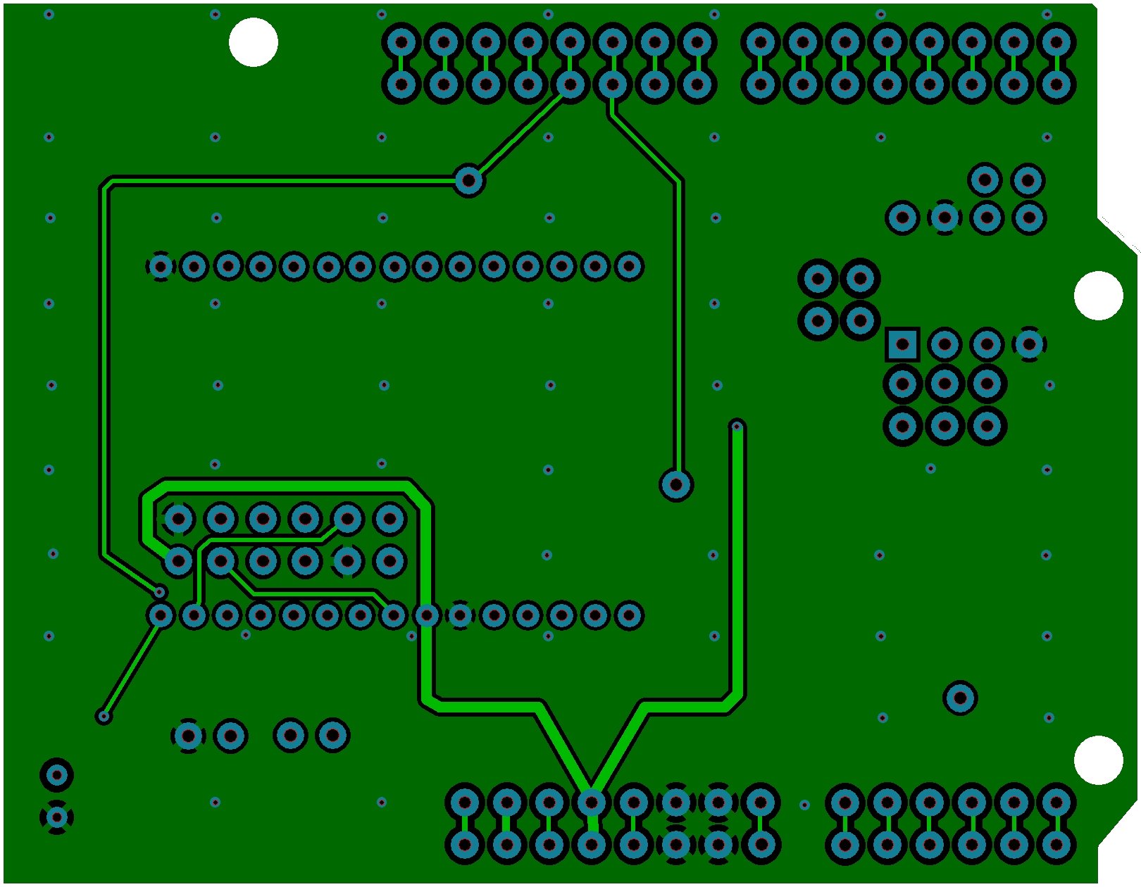

    Attachment 5600Attachment 5601
    Dave, I am in process of developing an embedded MCU application that will use the ConnectOne Mini iWiFi module. However, your use of the term "ethernet sheild" confuses me. By shield do you mean it provides an RF shield to protect the rest of the PCB containing the MCU from RF emissions? Is this PCB for use only with Arduino boards? Please explain so I know whether your "ethernet shield" would be of use to me.
    I would also appreciate your comments regarding whether my PCB layout must take any specific precautions in the layout and grounding techniques to properly interface to the iWiFi via its 2x6 pin header. I am currently planning on creating a "copper pour" area on my PCB that lies under the overlying iWiFi module, but not sure what is really required. I am kind of new to trying to integrate an RF module with an embedded MCU PCB.
