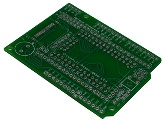

    This Amicus18 board...

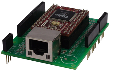

    when populated looks like this...
    . Name:  ethernet.jpg
    Which is both more powerful and far easier to work with than the Amicus18 project that Henrik is posting about.
    I don't have the time to post a similar project but maybe others will have a go.

    The bare board is here. The Tibbo components are available from Crownhill or you can buy it assembled here.

    ...and the EM1000 used above already has firmware to utilize the GA1000 WiFi board.
