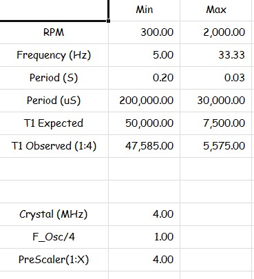

    I need to measure the RPM of a motor that would range from about 300 to 2000. Based on a thread in which Bruce had given code to measure the pulse width (only the width, not the frequency) of a signal using the capture function, I used the following code, modified for frequency. I used a square wave generator to test out the code, and the numders I get dont match up at all.
    Its a 16F628A running the internal oscillator.

    I'm also attaching a screen grab of my calculations.
    Any idea where the problem is, guys?

    So, the issue boils down to my having messed up the capture code in some indeterminable way; or my understanding of the prescalers being totally off
    The wrong results I get are very consistent for a given frequency. But, the ratio of observed readings to expected ones is not the same for different frequencies. Another mystery.

    Lets look at this and see what its doing:
    INTCON = 0 ' Interrupts off
    CCP1CON = %00000101 ' Capture mode, capture on rising edge
    T1CON = 0 ' TMR1 prescale=4, clock=Fosc/4, TMR1=off
    T1CON.4 = 0
    T1CON.5 = 1
    CLEAR
    Reload:
    TMR1H = 0 ' Clear high byte of TMR1 counter
    TMR1L = 0 ' Clear low byte
    T1CON.0 = 1 ' Turn TMR1 on here 'here you turn on the timer, but at what state is your signal?
    Next you wait for capture flag, but again, if the flag sets on rising edge (or falling) but
    you started in the middle of a "high", you will stop when 75% of the cycle is done.
    Capture = 0 ' Clear capture int flag bit
    While !Capture ' Wait here until capture on rising edge
    Wend
    T1CON.0 = 0 ' Turn TMR1 off here
    ' Rising edge detected / stuff 'captured' Timer1 value in T1
    T1.HighByte = CCPR1H ' I don't understand why you replace T1 count with CCPR1
    T1.LowByte = CCPR1L  'T1 has the counts you are comparing in your spreadsheet
    DEBUG #T1,13,10
    GOTO ReLoad
    You need to wait for a rasing edge before you start the counter, then on next rising edge, stop and get the counts. Or even better, set a word = to count, after you turn the timer off. then reset it and turn it back on. Right now you don't turn it back on until after you have sent data out. You are missing a portion of your signal this way.
