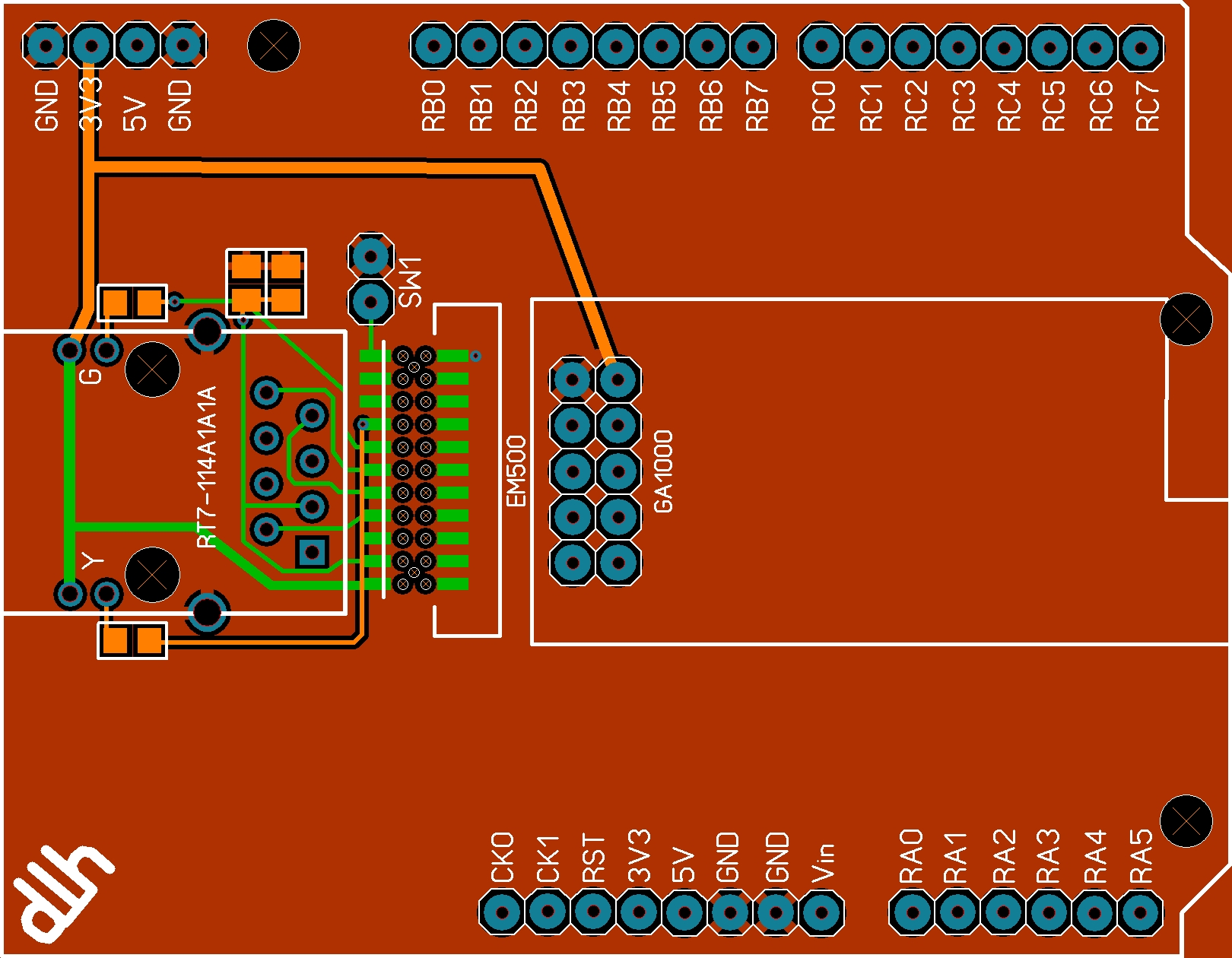

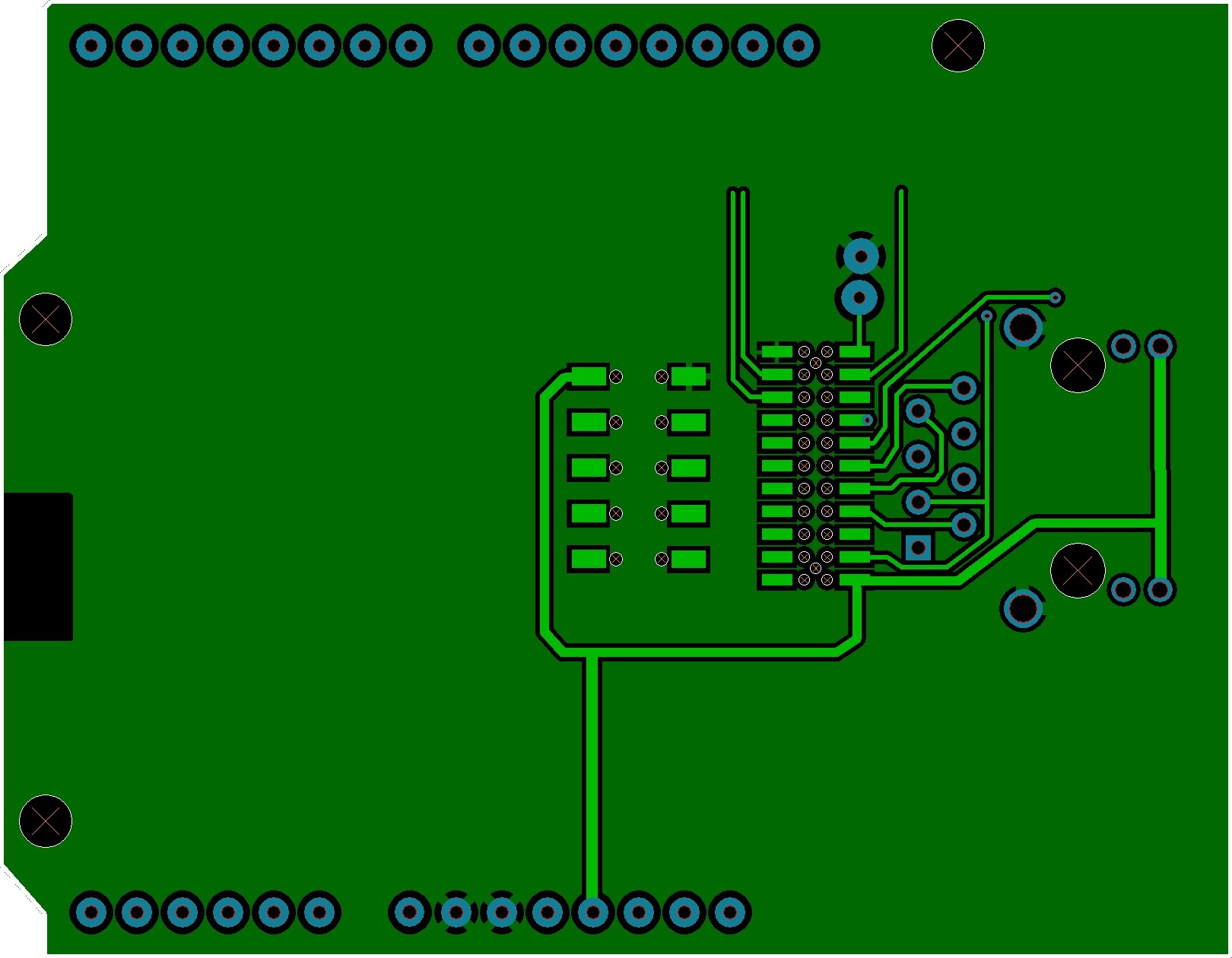

    Default Re: Amicus shields (A BEGINNING EM500/GA1000 LAYOUT)
    Here is my initial layout. It lacks connections and needs a few other tweaks. I'll wait until I receive the Xino Basic board I ordered and until Tibbo releases the long-promised firmware for the EM500/GA1000 combo.
    My health won't let me do much besides the prototype. If Bruce or Lester wants to offer it, the layout is my donation. Although, if Crownhill prices the bare shield at the £1199.99 inc. VAT price their web page has for the other bare shields, I'll want a cut should they ever sell one.
    These are much larger than life-size. Maybe a moderator can reduce them a bit.

    Nice work Dave,
    A big shield for little hardware :-)
    I work on a carrierboard with the Ami18 Stamp Module, maybe we have some place for the Tibbo module.
    A bit of progress - I've identified the terminals along top & bottom of the board and have 3V3 and GND for the EM500 & GA1000. All that I need now are to decide on TX, RX, & RESET for the EM500 and the SPI connections between the EM500 & GA1000. Are there any suggestions for RX, TX & RESET? I don't want to create any conflicts.
    The GA1000 page at Tibbo says...
    The module utilizes SPI interace and only requires five I/O line to control. Flexible mapping allows your application to use any five available I/O pins.
    This applies to EM1000/EM1202/EM1206 but it's unknown whether it will apply to EM500 until Tibbo actually releases the long-promised firmware for the EM500/GA1000 combo.

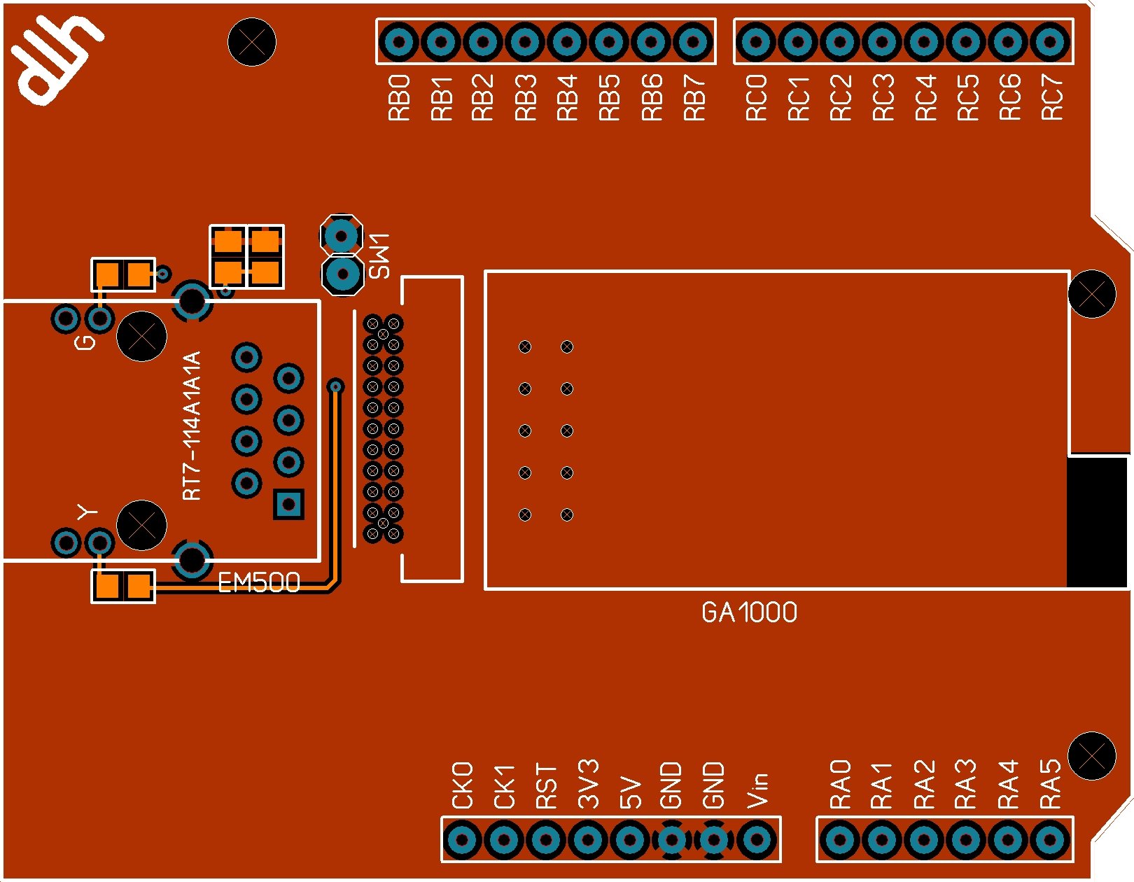

    Thanks for the kudos. I think the layout is more or less final. I want to see the XINO board before deciding on the TX, RX & RESET connections. And, the 8 unconnected pins on the EM500 form a GPIO port. Five of those pins (which five awaits the release the long-promised firmware) are used for an SPI link to the GA1000. I'll connect all eight to the GA1000 pads - that way users can just use a perf board with a male header to access the GPIO port when the GA1000 is not used. That keeps it simple and inexpensive.

    Oh, one change to the layout. I've doubled the pads around the perimeter so a scope or logic probe can access pins which are not used on the shield but may be employed in the PIC program being developed for a more permanent design.
