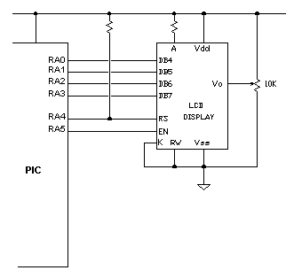

    You didnt mention it soooo, Do you have a pullup resistor on RA4?
    Read PICmicro MCU specific Issues in the manual ( sect 2.5.1 )
    Andrew
    Feb 2005
    Bellevue
    125
    Yes, 4.7k ohm on R4..
    i didn't have any of those LCDs in stock but, can you place a trim pot on Vo pin. or just tie it to ground to see if you get at least some black square on???
    Some LCD may need to place unused data pin to ground. Refer to your datasheet for that.
    try removing thos DATAUS COMMANDUS defines
    try a 2 secondes startup delay

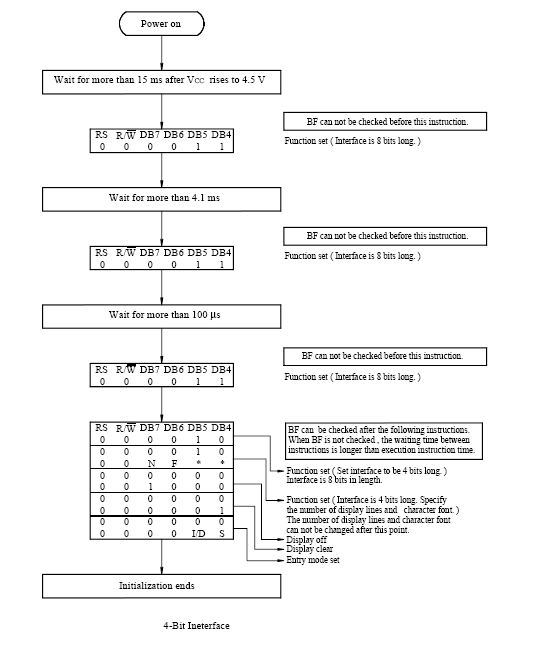

    Here is the startup sequence for 4-bits for this LCD display..
    I am going to try the POT on the VO line to see if that helps, but it has been at Vss and Vdd and nothing shows there.
    I am not sure how to comply with the attached startup sequence however... Where do I send the bit? When?

    ... Hmmm Now, I've got a POT on the VO which allows me to vary the cells from white to black. Still no data.
    Same goes for both of the LDCs I have here, so it must be something with the PIC's treatment of the PortA?

    OK, I have been going crazy on the 4-line LCD.. the book makes it look so easy.. I am trying to send it an initialization routine (which apparently I need to do?) This is a Crystalfontz unit which should be really nice... I attached the spec sheet in case an expert out there might be able to take a look. I am sure others will want to use these displays also.
    http://www.crystalfontz.com/products...2004LYYBJP.pdf
    In any event, I've taken all the advice here, and from the Mfg says I am seeing just what I should before it is initialized.. However I still get nothing on any LCD.. I *MUST* be doing something really stupid.
    Here is the initialization routine I sent (which did nothing) - from page 17 of the LDC data sheet...

    Feb 2004
    Germany
    762
    Tom,
    according to the datasheet the LCD has en embedded HD44780 (or compatible) controller.
    with this controller you don't need to "manually" initialize the LCD.
    The first LCDOUT command issued does all the initialisation for you.

    Interestingly, I see that the Crystalfontz displays require a pretty substantial intitialization routine. I can't tell if that is the same as what PBP send as standard or not.
    I downloaded a demo app, and it sets the bits E,RS,etc. high and low for about 10 seconds in a pattern that looks like it must be matching the tech notes for their displays. It takes the PC parallell port driver about 10 seconds to send all the bit settings, so I'd guess it is much more than 'standard'..
    The Crystlfontz guys don't seem to be able to provide details about exactly WHAT bits need to be sent and in what order to initialize the LCD.
    I think my time is better spent switching to an LCD that we KNOW works with PBP, which is too bad because CrystalFontz LCDs really look nice.
    Thanks as ususal for all the help folks!

    The Mfg sent along this note:
    quote: "All I see are row 1 and 3 with shading, rows 2 and 4 blank, and no text."
    This is a sign that the lcd controller is not initialized. A typical init sequence is:
    0x38 [wait 4mS] 0x38 [wait 100uS] 0x38 0x38 0x08 0x01 0x06 0x0C
    just like the data sheet shows. Apparently LCDOUT is not performing the init. I think it has an internal flag to keep track of the init, and it probably thinks it doesn't need to do it again. I'm not really familiar with that code.
    __________________
    Does anyone know how to 'manually send' those commands? What is 0x38, etc?
    Tom

    Tom,
    You definitely don't have to worry about "initialisation" with PBP and a 44780 (or compatible),
    PBP does it for you.
    you have either got a bug in your wiring or your LCD is "dead" (or even both)
    regards
    Ralph

    OK, folks. Thanks for the help. I am going to rewire this to another LCD and see what happens. I agree something must have gotten messed up or fried, it just is not that complicated.
    Tom

    If you're still using the 18F2525, then you need to change ADCON1 = 7 to ADCON1 = 15 or PortA is setup for A/D inputs, and you'll never get a response from your LCD.
    -Bruce

    Made the change, and adjusted brightness -- WORKS!!
    THANKS FOLKS.. It was the complexity of the 2525 and brightness adjustment that was holding me back.. Crystalfontz works fine. The support there is really good too!
