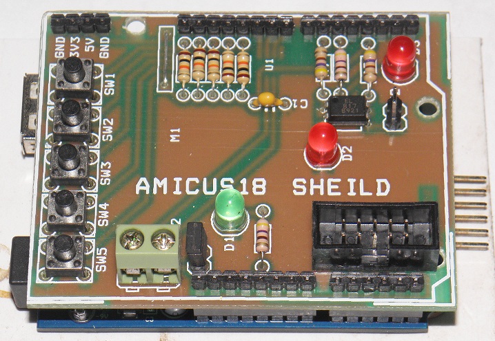

    Yes , Lester, you surely do have a point, but I still don't know , if the request is justified.
    Anyway, furthering my adventure on the Amicus18 platform, I made/Assembled my first Shield. I attach a pic of it. its basically a couple of switches, an output for a LCD, a MAX6675. and a LED on the CCP (HWPWM) port. The basic idea of developing this sheild was to experiment with the MAX6675 chip and further go on to make an reflow overn controller. I would surely be putting up details of the said sheild on myAmicus site soon.

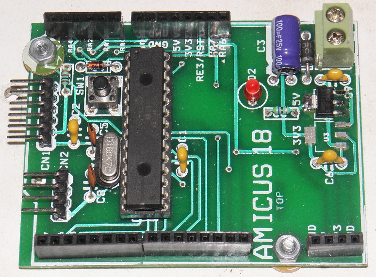

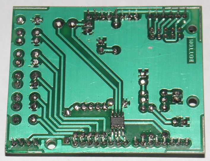

    I made a simple, no fancy , no frills, Amicus18 development platform adhering to original dimension for a shield. This Board, as you can see, does not have the USB FTDI section, so no bootloading possible. Alternatively, the UART pins are brought out at a 4 pin connector on the board. I would be posting the details of this board soon on myAmicus site for others to gain from it.
    I have used the 5V chip , 18F25K22 , along with it and it seems to work great.
    My first attempt to install a bootloader in 18F25K22 chip and run it on the original board flopped , hence I went this way. I am pretty much happy , programming this board with my PICKIT2 programmer and it works great.

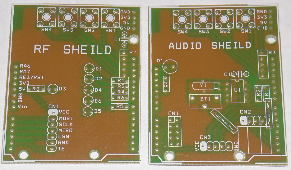

    I have just received PCB's for two more, new shields, that I intend to make for the Amicus18 development platform.
    • The RF Shield : This shield would help , to experiment and have fun with the CCxx00 series RF Transreceiver modules that are very easily and cheaply available in this part of the world. The Modules would be connected by means of a relimate connector to a daughter card , which could take, a CC1100 (3V), CC1100(5V) Longrange and a CC2500(3V) RF transreceiver module. This Board has 4 switches and 4 LED's with which you can make a 4 channel Remote Control.
    • Audio Shield : This is one of the most interesting projects that I have commercially developed using a 16F MCU and now I bring it to, on the Amicus18 Platform, This project involves a Battery Backedup RTC (DS1307) , 4 switches, to program the RTC, Alarms and a socket to connect to a Serially controlled MP3 module.
    More information on this would surely be made available , in due course, on myAmicus site.
    I realise, that, its easy to make a project, but documenting it for the purpose of sharing it with other on a forum is really , time consuming. But , surely it needs to be done, as "Sharing is Caring"
