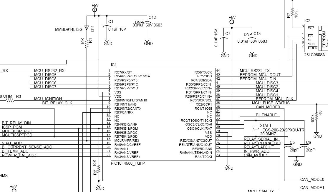

    Although not completle shown on the schematic I posted, the MCLR is pulled-up with a resistor and a diode, and it also goes to the U2 Programmer. I have also set the meprog to HS as show in the attached picture.

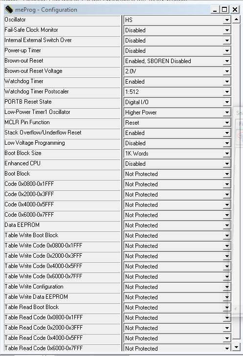

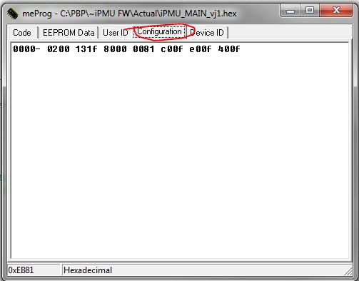

    Read the PIC back with your programmer, then view the config window. Do the config settings it reads back match what you expect?
    -Bruce

    Your config settings look good(screen shot). The U2 program has a pull down menu option which allows you to select between using the configs written in your code or from the config menu on the programmer. Try changing this setting and commenting your configs out of your code.

    Default Re: PIC18F4850 will not oscillate
    Bruce,
    I read back the configuration from the PIC, and it returned the following:
    0000- 0200 1f17 8200 0081 c00f e00f 400f
    Towards the bottom of the window, it has a 0xEB87. I can't really tell what this data means, so I am looking at the DS39622L document from microchip. But I really can't see how those two relate. Page 29, of the document shows the configuration bits and the CONFIG1H is located at 300001h.

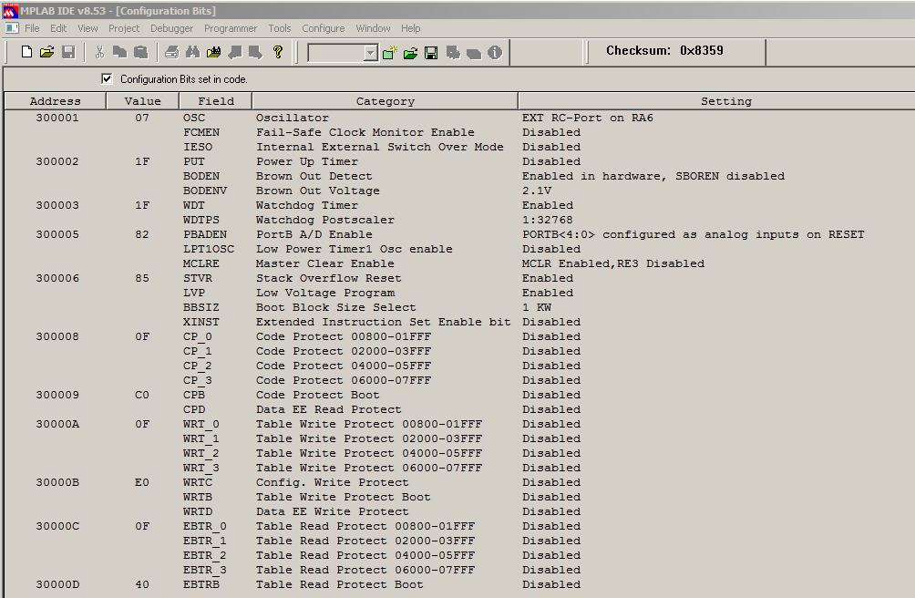

    So I made sense of the configuration read back results. And as I imagine the CONFIG1H is not being set by the U2 programmer.
    CONFIG1H = 02 (HS Oscillator enabled)
    CONFIG1L = 00 (default))
    CONFIG2H = 1F
    CONFIG2L = 17
    CONFIG3H = 82
    CONFIG3L = 00
    CONFIG4H = 00
    CONFIG4L = 81
    CONFIG5H = C0
    CONFIG5L = 0F
    CONFIG6H = E0
    CONFIG6L = 0F
    CONFIG7H = 40
    CONFIG7L = 0F
    The configuration file seems to be correct. Can anyone make sense of what is going on?. I have two cards behaving exatly the same.
    Last edited by IRQ_Diode; - 9th March 2011 at 00:06. Reason: Corrected the H and L on the CONFIGx table.

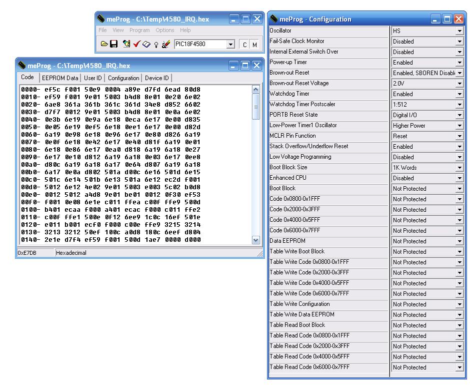

    When you read the .HEX from the PIC with your programmer, just click the C to view the config settings embedded in the .HEX file. Like you did in post #4.
    If it reads back with the settings you expect, then I would have to suspect a bad oscillator, caps, or something in the external osc circuit causing a problem.
    Double check those SMD caps to make sure they're not resistors...;o)

    I read the configuration back from the PIC and it reads the correct settings for the oscillator
    I have open a ticket with Microchip and contacted melabs to see if they have another idea on how to get this solved. I have tried two different oscillators.
    Has anyone used a PIC18F4580 that could let me know what oscillator they used (actual part number)?

    I am considering that it could be the actual part number of the crystal itself. The only thing I have not tried is to place a series resistor to one side of the oscillator. I would have to cut the trace and make sure that I do not short anything to the ground pour around the oscillator.

    :0E00000000021E13008081000FC00FE00F40B1
    :00000001FF

    You do still do not have the OSC set for HS
    Dave, I don't think you imported the .hex file.
    Here's what meProg shows ...
    Another silly thought. Some times you can open a hex file in the melabs programmer and it's not the latest. The compiler may be storing it in a different directory. You may be opening an older version of your hex file from another directory. As much as you modify your basic code, you keep programing the chip with the same hex. Recompile and check the date and time stamp on the file. I have used that chip before and it is not difficult to get working. If you post your code, someone can compile it and see whats going on.
    DOH!!! I imported something... Now that I do it again, MPLAB shows the same as you.

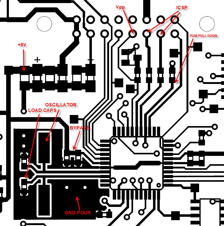

    It looks like all your smt caps are shorted in the PCb traces, is that possible ?
    Mar 2011
    10
    Joe,
    I am not sure what you mean. Are you saying if maybe the caps got shorted when solder?mmm... you know what I have not checked on that.
    After opening a ticket with Microchip, they could not help me much either. They thought that maybe I damaged the crystal when I solder it. Which I suppose it could be a possibility.
    Since I had to order new boards anyways, I placed the XTAL closer to the PIC (Maybe 15-30mils closer) and the new boards work fine. So I am not sure what happen before but I guess it is one of those items I will not find out what happen without using up more time that I already have.
    Thanks for the help.

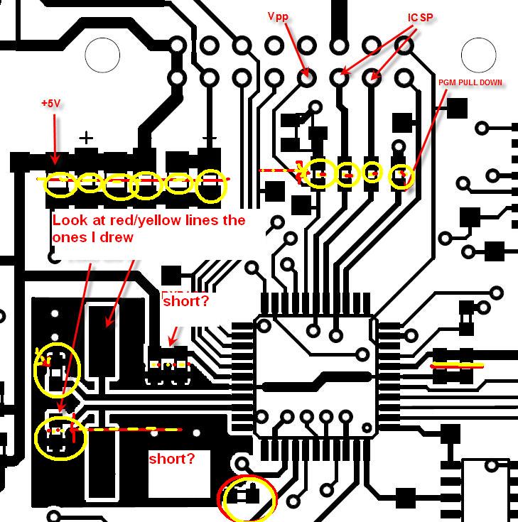

    Not a solder bridge, but copper where it should not be? Looks like the traces bridge the caps and some other components. Looks like exacto knife time.Name:  shoer.JPG
    Mar 2011
    10
    Joe,
    I see what you mean now. My bad, the layout I uploaded is black and white, and the component bodies are part of my capture. Those aren't really copper, they are just the bodies of the components.
