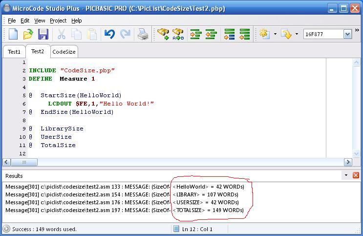

    I use MicroCode Studio Plus... I think it tells you the memory used in the Status Bar.
    Where? I don't see it.
    Quote Originally Posted by circuitpro View Post
    It tells you in the status bar, here. But you have to have it turned on with:
    Define Measure 1
    (and include the include file, of course)
    http://www.scalerobotics.com
    Bottom left hand corner after you compile.
    Success:blablabla bytes used.
