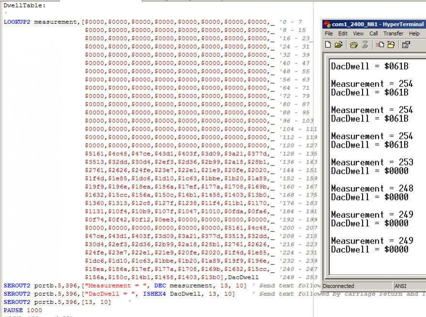

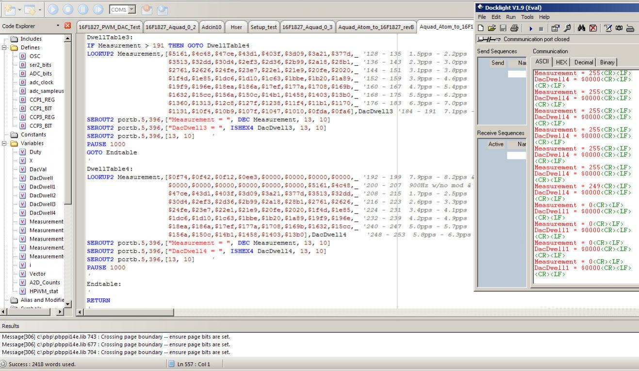

I was trying to implement something like that earlier as part of trying to fix the table issue. Now that the tables are fixed it'll be nice to loose all the leading zeroes!
This project has been challenging but interesting.
It's an audible annunciator with a variable sweep tone burst to indicate urgency, with a variable frequency amplitude modulator.
All scaled to fit within the table limits of PBP!
