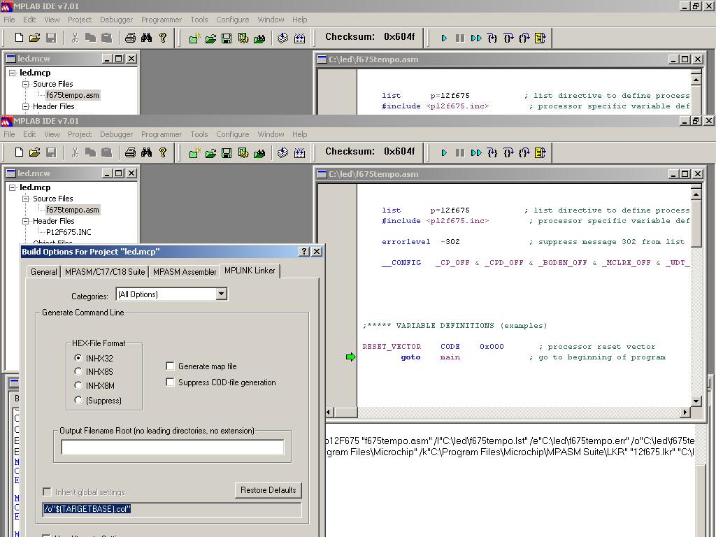

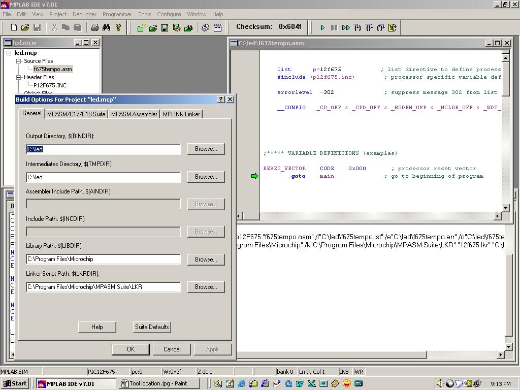

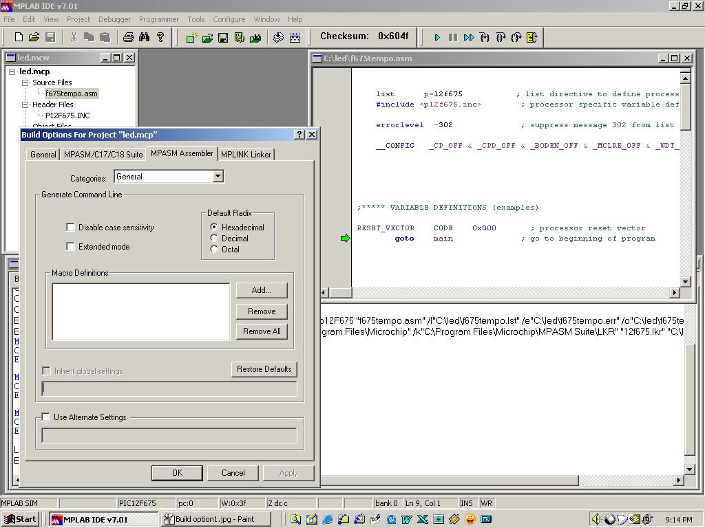

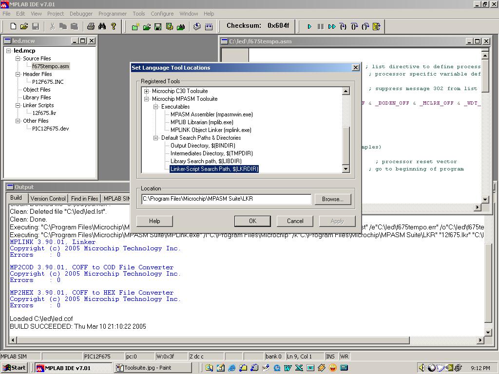

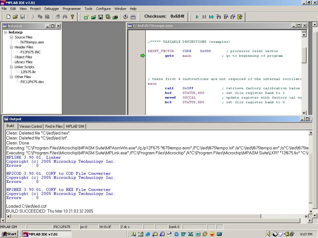

    I'm lost and I'm out of ideas how to make it work.
    I start building a NiMH charger , but first of all I can't make blink a led.
    I have tried some other blink.hex (downloaded) to check my hardware and the led blinks.
    When I try to compile my *.asm file or those downloaded the resulting hex doesn't work - I supose my MPLAB settings are wrong, but where?
    This is my code

    Hi everybody,
    Finally I found where the problem was hidden.
    All my *.hex files are generated in a format which has at the end of the file a double 'retlw0'
    :0E01200083161E08A2000800851605120511A0 ;code in hex format
    :02012E0000349B ;0034 - retlw 00h
    :02013000003499 ;0034 - retlw 00h
    :02400E00843FED
    :00000001FF
    As you can see the last 4 lines are -my code
    -2lines of retlw 00h :02012E0000349B
    - config :02400E00843FED
    - end of file :00000001FF
    I checked the hex format at "http://www.cs.net/lucid/intel.htm"
    I don't know yet all the details but after I deleted the 2 lines of retlw 00 and burn the new code resulted in the PIC, it just worked.
    For those who build a code and have a successfully compiled *.hex file with no errors:
    -when the code is burned into the PIC and doesn't work maybe this unscientific fix may work.
    Mike
