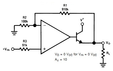

    I'm guessing from the thread title that OP is using an external DAC - so PID is not needed. The MCU's I use have a built-in (dual-channel) 12-bit DAC and I have done something similar. The DAC output is scaled to 2V full scale. An op-amp (rail-to-rail) buffer with 6x gain and a simple linear output stage gives 0-12V output with 3mV resolution.

    That is the purpose of the op-amp/buffer as in the figure below - the DAC provides the Vin. The gain is changed by altering the values of the feedback resistor pair R1, R2. Gain = (R1+R2)/R2.

    OK, it is the Vref voltage of the loop that is controlled. So the PIC is not in the output voltage loop.
    OK, it has some cons, but with a high resolution DAC it will work just fine.

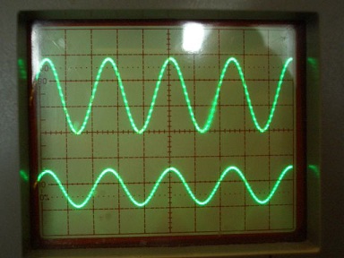

    Using this method (MCU->Hi-Res DAC->Buffer/Amp), you can not only make the digitally controlled power supply of your childhood dreams but you can also turn it into a fully programmable unit that can generate all kinds of waveforms - very useful for test purposes. For example you can program it to generate stuff like sine, triangle, sawtooth, staircase and other custom waveforms. The trace below is a sine waveform generated by a 12-bit DAC. The timebase is 10uS/Div so the frequency is 40KHz.
