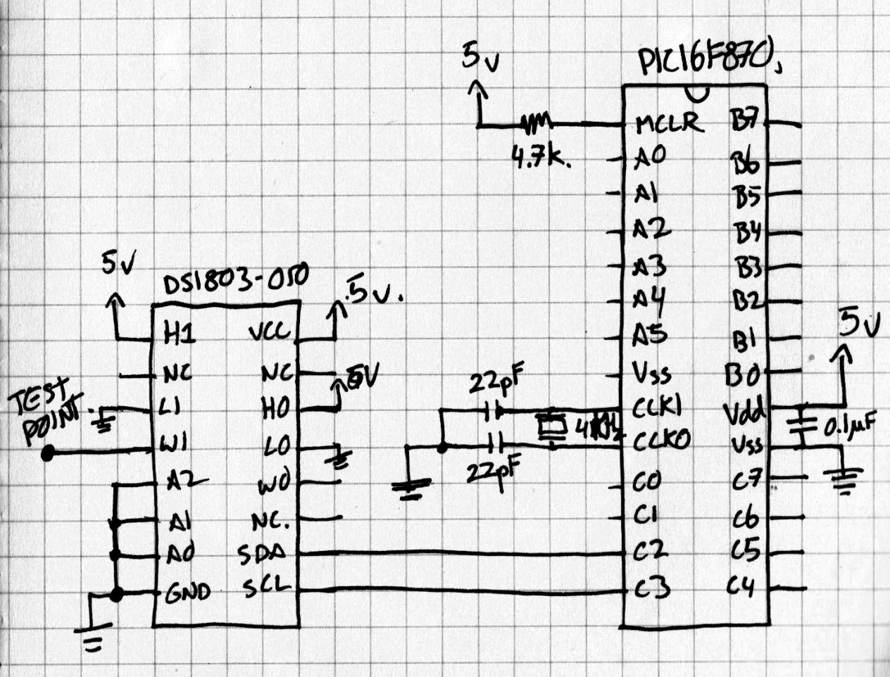

    I'm having problems with the DS1803 010 (10Kohm) digital pot.
    This is simply a test circuit - ultimately I'd like to use the device to alter the brightness of a LED. Problem is, the simple circuit doesn't work. I have a feeling it may be an address issue. Any help from those more experienced would be greatly appreciated!
    code and circuit diagram;Name:  circuit diagram.jpg
    Button1 var portb.7     ' low is pressed
    led1 var portb.6
    SDA VAR portc.2
    SCL VAR portc.3
    B0 var word
    LOOP:
    '***************** VARY POT OVER RANGE **********************
    FOR B0 = 1 TO 255
    I2CWRITE SDA, SCL, %01010000, %10101111, [B0]
    PAUSE 10 ' Wait =>10 mS for write to complete
    IF B0 = 255 THEN LOOP
    NEXT B0
    GOTO LOOP

    The 2nd word, "command" should be 101010xx where xx=which pot.
    Why"IF B0 = 255 THEN LOOP"?

    Hi Ron,
    Thanks - that line you point out is indeed unnecessary.
    However, the 2nd command word, which I have at "%10101111" is the correct command to write to both pots according to the datasheet.

    Hi Ron,
    Solved the problem - the value being written was a variable of type "word", where it needs to be a byte.
    Thanks for your assistance.
