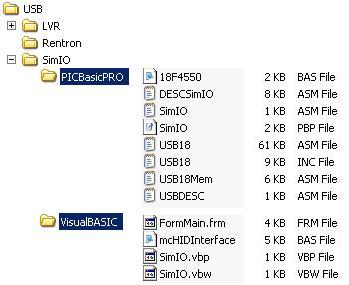

    You should have 8 (PBP) files total generated by EasyHID. All this stuff is required, and included when you compile for the 18F USB part.
    Look in your PBP\USB18 directory for USB.TXT. This explains what most of
    the files are.
    -Bruce
    tech at rentron.com
    http://www.rentron.com

    Thanks Bruce, that's the only place I hadn't looked for help.
    "The header file for the device, the files USB18.ASM, USB18MEM.ASM, USB18.INC, USBDESC.ASM and the project descriptor file, as well as any desired sample programs, should be copied to the project source subdirectory before being used."
    Ok, so we just have those files sitting there when we compile and the compiler takes care of everything, cool!

    Hello. I don't know what happend but my EasyHID only create 4 files:
    DESCUSBProject.asm
    USBDESC.asm
    USBProject.asm
    USBProject.pbp
    What i doing wrong? why it don't creat the other files like the USB18.c
    Thanks for yours help!!!

    I have sent the reply straight to your personal email address. It would appear that the files aren't generating properly. All i can suggest is check the compilation settings again. If that doesn't work, try installing the application again.
    I certainly haven't had any problems like that.
    Within the directory you specified in the project settings (default is C:\Program Files\Mecanique\EasyHID\) should see another directory as per your title, such as USBProject. Within that directory is 2 sub directories, one for the VB or C code and one for the Proton or PICBasic code.
    I have sent you a zip file containing what you should expect to see for a default VB and PICBasic code using the PIC18F4550 also with all the default settings.
