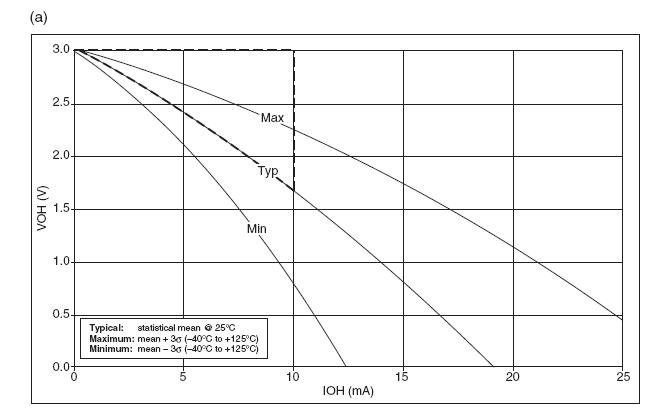

The reason it works on the PIC is the internal resistance of the pin in the PIC. For example, the following graph is taken from the 16F84A datasheet from the AC/DC Characteristic Graphs section.
By calculating the slope in the dashed line it can be determined that the internal resistance for VOH = 3.0V is equal to ROH = 130 Ohms. Now, in the case the output is low, VOL = 0 then the VOL-IOL graph is

So, in the case that you are using a regulator of 3.0V you will have an equivalent PIC resistance of 130 Ohms; therefore, there is no need for an external resistor.
More detailed information about port characteristics can be found in the next book in chapter 3.
