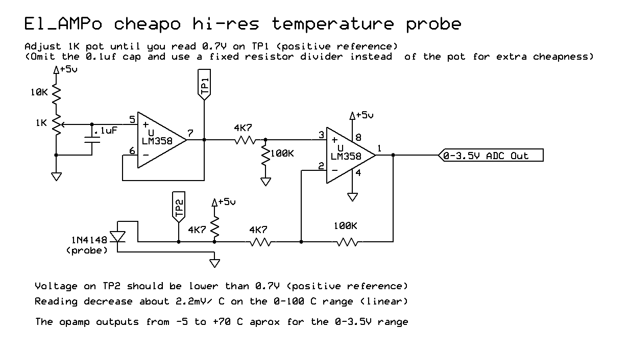

    If you want a really CHEAP thermometer with decent accuracy use a diode as a sensor.
    Here is the schematic:
    Name:  temp probe.png
    Still working for me at a 0.5ºC resolution, but needs a two point slope calibration, some chip math and a pic with ADC.
    Maybe the 10bit ADC will give you a resolution of 2-3ºC, maybe less with oversampling with just the 4k7 resistor and the diode directly to the adc.
