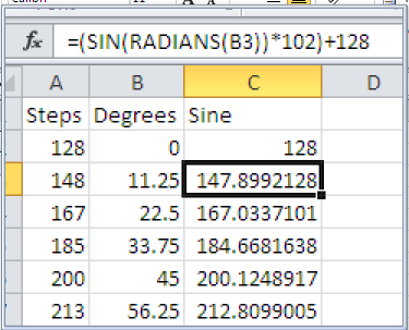

    To be quite honest, I copied them from the application note I reference in the example I gave. It shows you a little more about it in the notes in the assembly code. If you wanted to make your own, you just need to figure out how many steps you are going to make. If you were doing 36 steps, each step would be 10 degrees. Sin(10 degrees) * 102 + 128 = number. In the Microchip example, they had the max = 90 percent. So 90 percent * 255 = 230. 230 - 128 (the midpoint) = 102. So it will swing + or - 102 from the midpoint (128).
    Then we can make a spreadsheet for our steps. I put the Microchip steps in on the left, then degrees for each step, then the formulated value on the right. As you can see, these pretty much match the Microchip values. You would have to do something similar for your 72 steps.

    Do you know Excel?
    Here is 5 minutes work. Left side is 0 to 255. Right side is 0 to +127 to 0 to -127 to 0.
    Graph right side!

    Default Re: sinusoidal PWM
    You're still off on the array.
    Sinval VAR BYTE[32]
    This creates an array of 32 elements numbered 0-31 but you assign values to it starting at 1 and ending at 32 - not very good. There is no SineVal[32], when you read/write to that variable you're actually accessing the "next" RAM location, something I'm sure you don't want to do here.
    You can adjust the peak value by "scaling" the value in your sine-table but really, you're not even 2% off target.
    Are you using a 4MHz x-tal like the code says or are you using something else?
    If I'm not mistaken a reload value of 65505 with a prescaler of 1:8 running at 4Mhz gives an interrupt frequency of 4032Hz, you have 32 "steps" to your cycle so you "should" get around 126Hz....
    For accuracy it's usually better to stop the timer and then ADD the preload value to the timers current value since this will take into account the interrupt latency etc. Stop it, copy it to a WORD, add the reload value, copy it back and restart the timer.
    Any specific reason you're using a TMR1 prescaler of 8? Using a lower prescaler ratio will give you better "resolution" on the interrupt frequency.
    Feb 2011
    37
    hellow Henrik,
    thanx for the tips, i've re-worked my sine table,also i've include the code for accuracy although i'm not sure if i've place it in a right place!
    For a 4MHz xtal and TMR1 prescaler of 1 i reload the T1 with the value 64980 to get 50Hz and it's what m getting on the scope.
    Also TMR2 with prescaler of 4 is loaded with 117 for the interrupt to be generated every 556us(256-(556/(4*0.25*4))
    But the problem is that the waveform i'm getting on the scope is not smooth at all....Simulation results..pdf

    where i'm wrong in the code? are the calculations above correct?

    Several things.....
    TMR2 is the timer used for the PWM generation. The fact that you initially load it with 117 doesn't matter for either the PWM frequency or your interrupt frequency since you're using TMR1 to generate the interrupts.
    You have the prescaler for TMR2 set to 1:4 and PR2 set to 13 which indeed gives you ~18kHz PWM frequency but it'll only give you a give you 56 discrete dutycycles. Ie. the maximum value you can put in the dutycycle register is 56. The highest value in your sine table is 242 which you then shift right one time bofore putting in the CCP1L, so you're trying to put 121 in there when 56 is max.
    Changing the prescaler to 1:1 and putting 55 in PR2 gives you the same PWM frequency but allows dutycycle values of 0-222.
    TMR1 is now setup with a prescaler of 1:1 and you reload it with 64980 making it interrupt every 65536-64980=556us or at a frequency of 1798Hz, there's now 36 steps to your "cycle" so 1798/36=49.96Hz so it seems to be correct. I don't think you should expect to be able to run much faster than that at 4Mhz, the DT-ints takes quite afew cycles to save and restore all the system variables on each interrupt so you won't have much time left.
    The "accuracy thing" needs to be performed on each reload or it won't have much effect. It should be in your ISR instead of the reload code you have there now.
